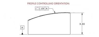

In the scheme proposed in CheckerHater's figure for "profile controlling orientation", does datum feature A and the existing dimensions (such as the non-basic height of the right upper corner) constrain translations of the true profile axis parallel to the XY plane (right-left-up-down on the drawing view)? If not, the tolerance zone is free to float in these directions, and from that, it should be clear why both the geometries of part 1 and part 2 in my sketch are acceptable.
How exactly tolerance zone translates up-down?

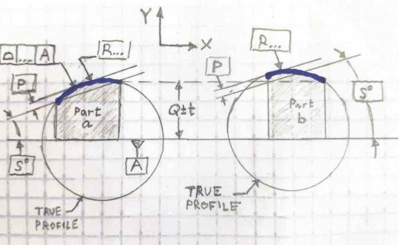

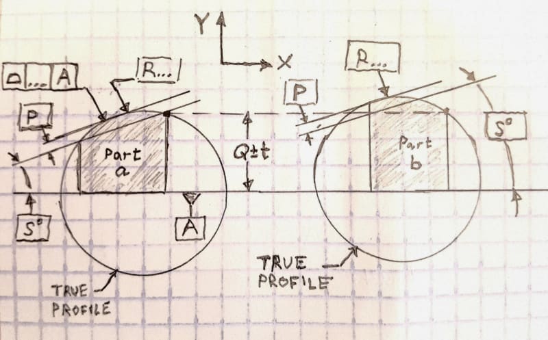

I made another sketch. Hopefully, it will help to explain the idea better than my previous one.
Sorry if I will sound like a broken record now, but first it needs to be acknowledged that only the datum reference frame constrains a true profile, which must be basically related to it, for profile tolerance definition. Physical part edges, corners, or plus-minus toleranced dimensions that are specified to locate these features - theoretically can be ignored when establishing a true profile. That is especially true if they are not referenced as datum features and do not have any interface with the datum feature simulators related to the profile specification. This is very "basic" (pun intended) and I truly hope this is something we all can agree on.
In the image below, datum feature A is the only datum reference and it constrains 3 degrees of freedom. Among the degrees of freedom that remain unconstrained are X and Y translations. The tolerance zone is disposed about the true profile, simulated by a full cylinder the diameter of which is two times the basic radius specified.
"Part a" is a part the designer is happy with because it turned out to be exactly as modeled. When "Part b" was inspected, the true profile and the tolerance zone that is fixed coaxially to it utilized the available freedom to translate parallel to the XY plane, unconstrained by datum feature A. Therefore part b also was accepted, even though it definitely didn't come out as the designer intended. The Q+/-t height dimension was produced as accurately as in the other part, but the "orientation" of the arc is completely different than what was intended. That is because, without additional constraints, the basic angle can't do its job. The degrees of freedom that remain free make the basic angle toothless. Note that I use the apostrophes for "orientation" because everything that happens here is very different from how orientation controls work for plane surfaces or axes and planes.

Belanger,
The blue portions you emphasized do fall within the tolerance zone in both cases. I didn't show in in the sketch but the tolerance zone is fixed to the true profile. The true profile defines the tolerance zone:
From ASME Y14.5-2009:
"8.3.1 Uniform Tolerance Zone
A uniform tolerance zone is the distance between two boundaries equally or unequally disposed about the true profile or entirely disposed on one side of the true
profile."
Any portion of the tolerance zone (in the example - two coaxial cylinders disposed about the true profile) can be used for the profile evaluation. The two parts are approved by being best fitted into different portions of the tolerance zone (which you showed in blue). I assume you know that the length of the tolerance zone is not limited by the length of the feature. For the tolerances to apply "for full depth, length, and width of the feature" the tolerance zone being established should extend beyond any limits set by the dimensions of the part.
When best-fitting for profile inspection, the tolerance zone (and the true profile) can shift relative to the DRF together with the considered feature, in the degrees of freedom that are not constrained by the datum references in conjunction with basic dimensions that define the true profile relative to those datum features. and as you can see there are no basic dimensions connecting between the true profile and datum A apart from the basic angle that doesn't prevent the shown shift.

So to go back to CH's picture (24 Jun 20 18:38) titled "profile controlling orientation" -- shall we conclude that datum A is meaningless there (unless the true profile were tied to it with basic dims, etc.)?
In Model Based Definition (MBD) that profile callout on CH's illustration would be "consumed" as location control regardless if the vertical dimension was basic or +/-. To make it something else than location control, the feature control frame would have to be modified, not the dimension type.

What is needed is additional constraints that will make the tolerance zone control what you want it too. What CH's "orientation profile" attempts to do is to set a specific ratio between the heights of the right side face (where it's controlled by the toleranced dimension) and the left side face. To achieve that by the profile control, these two side faces or one of them should definitely be involved in the datum reference frame. This can be achieved even without giving up on a toleranced dimension to control the height. I proposed a solution but it was ignored. Apparently solving it was of less interest than insisting that the original scheme can work.

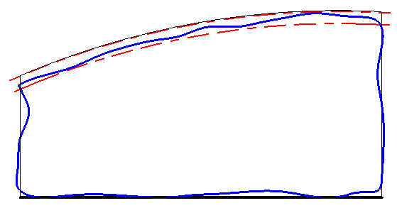

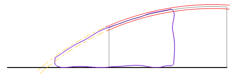

OK I think I see what you're getting at - I didn't understand it before. The Part 2 contour in your figure from June 25 at 10:22 was created by extrapolating the arc-shaped tolerance zone boundaries and extending datum feature simulator A. Like this:
Is this the kind of effect you''re thinking of?
It seems ridiculous at first glance, but I'm not sure if there is anything in the standard that disallows it. This could occur even if the height dimension was basic.
