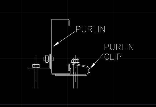

Jun 24, 2019 #1 sujeeth198 Mechanical Joined Jun 24, 2019 Messages 1 Location IN I am working on a project where i have to support the Fire Pipes from a z purlin. Is it advisable to support fire pipes using Gripple wire support, hanging from a Z purlin. Any any other ideas ? Kinldy advise.

Jun 24, 2019 1 #2 MatthewJWillis Mechanical Joined Nov 19, 2014 Messages 283 Location US I am not sure what a "gripple" wire is, but it does not sound like a listed attachment? Any items touching the structure, or the pipe, in Fire Sprinkler applications must be listed. Normally, if permitted by the Steel Manufacturer, some sort of "Sammy Screw", or other approved means is to be used. I would strongly suggest checking with the provider of the steel for input on their allowed methods as well. R/ Matt Upvote 0 Downvote

Jun 24, 2019 1 #3 UFT12 Mechanical Joined Mar 16, 2016 Messages 324 Location NL you could try also hanging this way, either with an angle or a clip. Upvote 0 Downvote
Jun 24, 2019 1 #4 MGXFP Mechanical Joined Jul 30, 2002 Messages 426 Location US Sammy sidewinder or Sammy Xpress for Z purlins. I think your Gripple system is only listed in the UK. Upvote 0 Downvote
