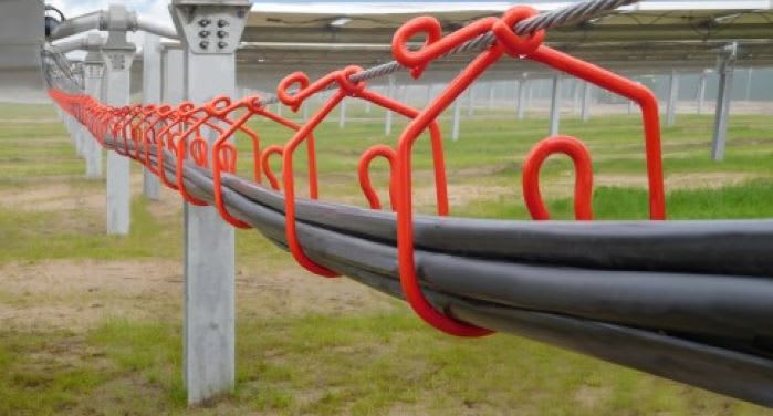

Interesting, I might be able to make that work with the right cable and a ring every ten feet or so. I have to run about 400 feet through mostly open space, in that 400 feet there are structures for old chip lines about 50 feet apart. Trying to run almost horizontal, 1/4" per foot slope just to keep condensate moving downhill. Here in Maine I need to add in wind, snow and ice to the pipe and insulation load.

Design for overhead traffic light systems looks the best bet to me. Lots of them are >20 span.
To keep your pipe straight you will need variable length hangers to cope with the supporting cable sag.
