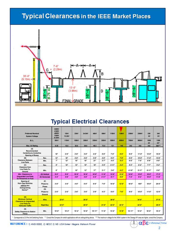

Thanks for the suggestions. Do you guys see any concerns with 5m conductor drop, which would be same for both options?
Should not be a problem assuming that the gantry phase-to-phase and phase-to-ground distances are at least 12.0'(3.66m) and 4.3'(1.32m) respectively, should not be any problems for wind speed up t0 90mi/hr (145 km/h).
For general references, see a typical design guide below.
