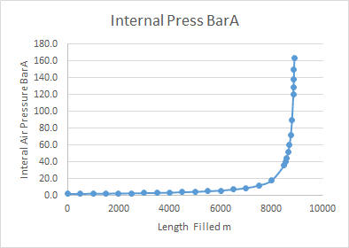

Yes,am aware this is a subsea line. Free flooding a 0barg line at 1300metres depth with ? Dont need to run any calcs for this. Am presuming this 12.7inch line valve at 1300m depth is wide opened suddenly. It would take ages for the built up line pressure in a 9km line to build up to a point when the inflow velocity is reduced to 3-5m/sec.
Limit the inflow to filling the pipeline to 3 to 5m/s max. I don't think that will be a problem with the 130 Bars of pressure you have available. Velocity across the inlet valve will be sonic, limiting press drop across the valve to what I estimate will be 1/2 of the pressure differential. It will take only 30 to 60 min to fill 9000 m at those filling velocities. Internal air pressure will not increase very much for awhile, only doubling by the time half of the pipeline has been filled and doubling again when you fill 3/4 of the pipeline. You should reach 20 Bar at 8000m filled and 130 Bar at around 8860 m filled. Don't open the vent valve at the end of the pipeline until then when the initial air internal pressure (assumed at 2 BarA) is nearing the 130 BarA outside pressure, or the pipeline will fill with water from both ends.

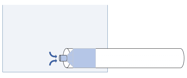

Thank you all for your insights. They are steering me in the right direction. Just to clarify the problem, I´ve attached a diagram. I´ve added an inlet. Research has lead me to a coef. of discharge or resistace coef.
Assuming and infinite tank, smaller diameter inlet. Same pipe length and depth.
Good. Inlet will let the water go in. Would be difficult without that.
Do not forget about outlet for air at other end.
you'll have choked flow for sure.
