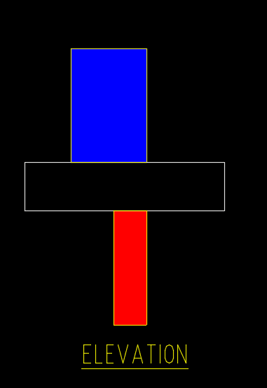

I have this offset column as shown below. The transfer point load from the column above is 1000kN.
I am at a point where I can design it using strut & tie or a normal beam as per AS3600 since strut angle is about 30 degree.
When I design it as strut tie, I find the strut strength fails while it passes easily with ligs if it is designed as a normally beam. The reason why STM fails is strut strength has been reduced a lot by efficiency factor beta_s and it doesn't consider the ligs contribution even if I add ligs in. The Code does allow me to consider the enhancement by the reinforcement, by which I can design the strut as column. But the reinforcement has to be parallel to the strut with ligs at a angle in this case as well, which is not practical.
My question is, if I provide normally vertical ligs, how much strength the strut will improve if I design it using STM since the strut has been confined in some way. Any thoughts?
I also have this column transition issue that I think STM is applicable as well. But the strut strength just fail a bit. I believe providing vertical ligs will improve its strength but the Code doesn't cover this from what I know.

4) There are a number of approaches to the column situation and it is partially dependent on the story that you wish to tell there with respect to the maintenance of equilibrium at the joint. One common, low effort approach is to treat the overlapping area within the slab/beam as a short column in it's own right. Rebar, stirrups, etc as required. This often means that the upper and lower columns are designed to share the moment generated by the eccentricity within the joint rather than also sharing that moment with the adjacent slabs/beams which is yet another approach,

If the overlapping area is very small, say 150mm x 200mm only. Does that mean we need to design the 150mm x 200mm to take the entire axial force from the upper column?
4) Yes, if and only if you use the method that I described in my previous post. There are other methods such as straight up strut & tie. Unless your slab is very thick, you may need some kind of localized slab thickening (beam, drop panel...) at the joint in order to make a strut and tie check pan out.
Thanks for your detailed explanation.
If I want to design it this way, how do I confine this overlapping area considering the area is so small that no enough vertical bars (<4) can be placed for the ligs? If I use the STM the inclined bars and ligs will not be practical and even if it is, how do I deal with the detailing such as splice? Looks like drop panel is the only option given that this offset column can not be avoided, but the architect will say no.
1) 150 mm x 200 mm may well be too small of an overlap for this stragegy. Draw it scale, run some numbers, and let your judgment be your guide.
2) I don't know that you actually need ties for the overlap with this. You might omit them altogether if the bars are stocky enough or get your confinement wiht U-bars etc.
3) In the absence of ties, maybe just stick two large diameter bars in there to get the job done.
4) I agree that inclined bars for the column joint strut will likely not be practical. The strategy that I proposed really has the over lap reinforcement as vertical dowels that terminate into the members above and below as non-contact, offset lap slplices. That may mean concentrated ties at the top of the low column and the bottom of the high column to deal with burstnig stresses there.

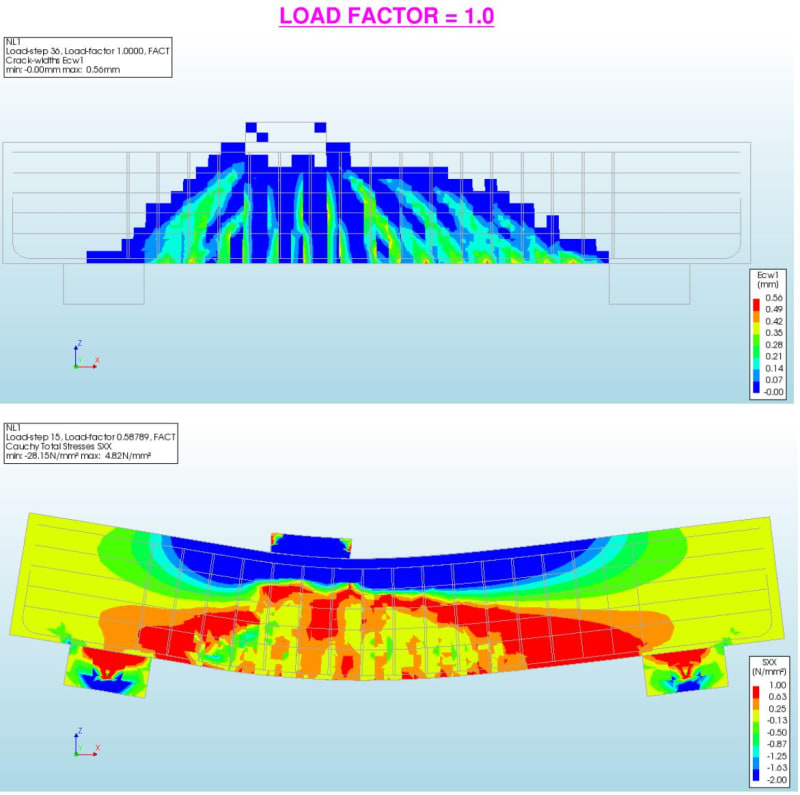

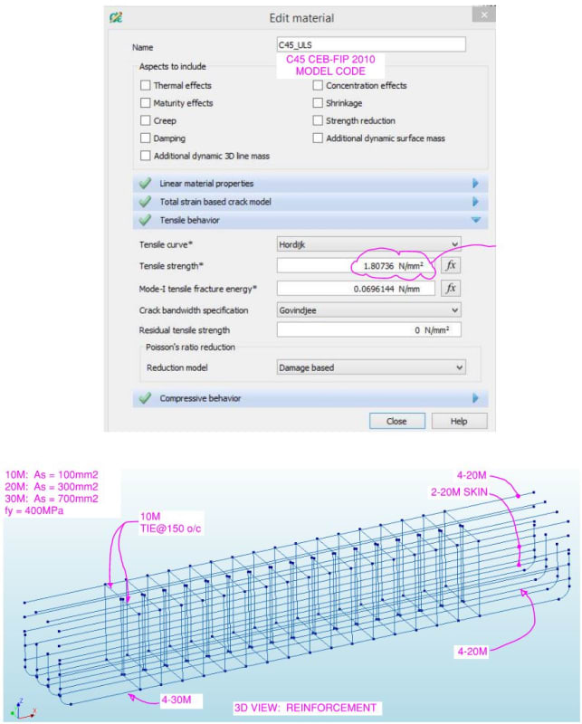

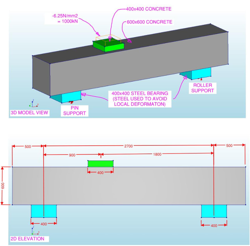

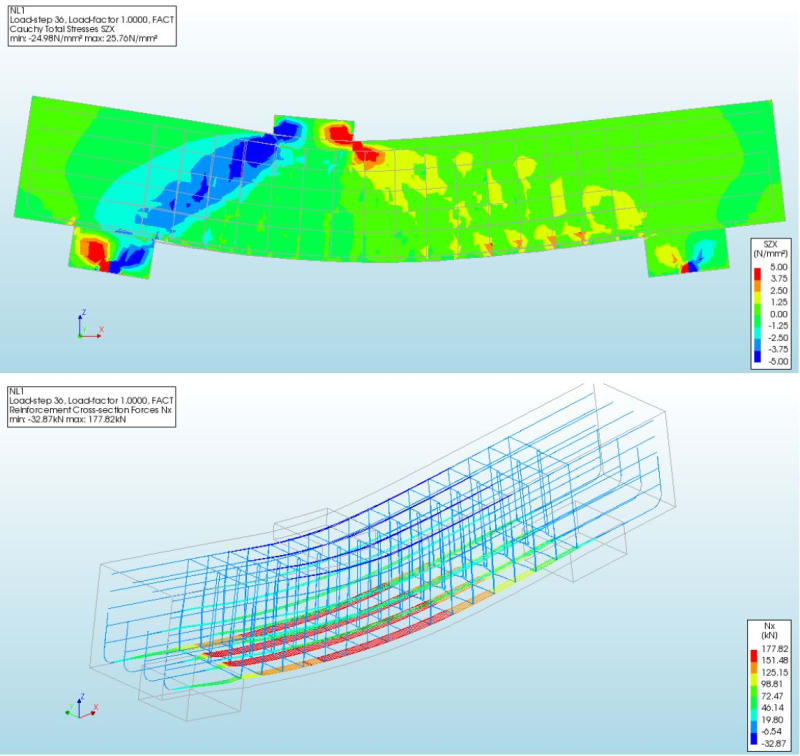

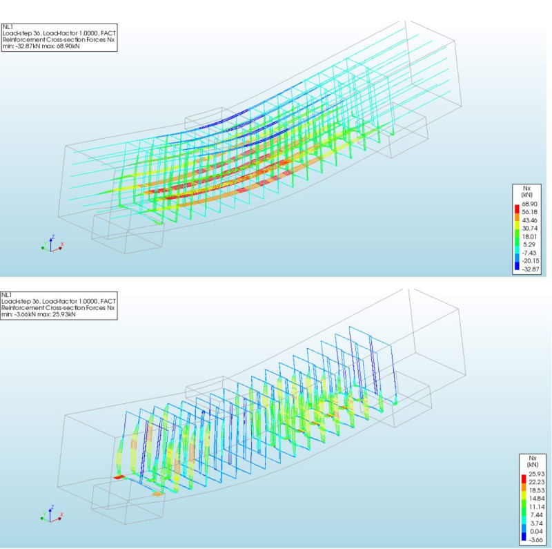

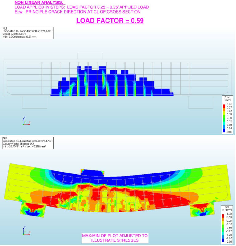

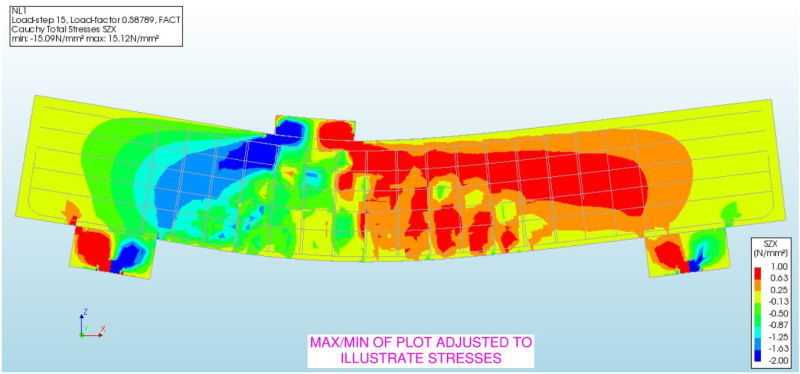

To help show the flow of the forces I mocked up a model based on some assumed dimensions and parameters. I don't mind re-running the analysis if you correct the dimensions. This problem has popped up a few times and I was interested. It is easy to include the rebar and additional parts being discussed if you include a sketch. I have been using this software for another project, so I used a C45 concrete material model from the CEB-FIP Model code 2010. That too can be changed easily.
Model dimensions used:
Concrete material properties and reinforcing:
Load Factor = 0.59 Ecw and SXX
Load Factor 0.59 SZX Stresses:
Load Factor 1.0: Ecw and SXX
Load Factor 1.0: SZX and Bottom Reinf Forces
Load Factor 1.0: Mid Reinf and Tie forces
