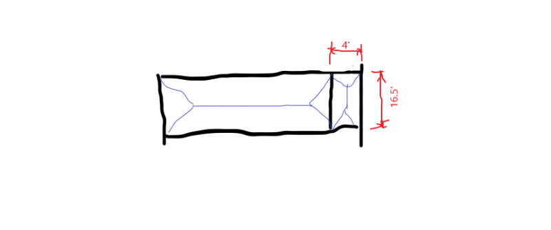

The 3rd and 4th floor each have a 6" concrete floor...so just taking a 40 psf apartment load (actually is correct for the period also) plus a 75 psf floor weight, each of these B10's would be seeing 1,035 lbs/ft.
pittguy12,
Let's have a sanity check on the 10" beam load, using the weigh you provided earlier w = 40+75 = 115 psf.
Calculate areas tributary to the beams:
Aleft = 0.5*16.5*(16.5/2) = 68 sf
Aright = 0.5*4*16.5 = 33 sf
Atrib = 68+33 = 101 sf
Beam load = 115*101 = 11615 lbs/2 beams = 5807.5 lbs/beam
Convert to uniform linear load w = beam load/beam length = 5807.5/16.5 = 352 plf/beam
Is this what you got? Or there is mistake in my calculation?

Retired13 ... I, admittedly, and not good at following along with someone's calculations. But let me do your sanity check a different way...
3rd floor load 115 psf
Trib span of floor to north wall = 10'
distributed load on beams = 115 psf * 10'-2" = 1150 lbs/ft
4th floor load 115 psf
Total load on beams = 2,300 lbs /ft
Divided by 2 beams = 1150 lbs / ft
pittguy12 - I assume you also have the self-weight of the wall included in your calculations as well in addition to the 1150 plf you show above.
oittguy12,
I see where I got it wrong, I was thinking about the 2nd floor only. In this sense, the 18" beam at the 2nd floor may not fare very well either. Have you checked one to see if it works?

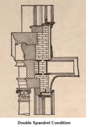

FWIW, this morning I was watching a webinar on antiquated building systems, the speaker mentioned the double spandrel. One supports the floor and the other supports the wall.
Very informative and interesting.

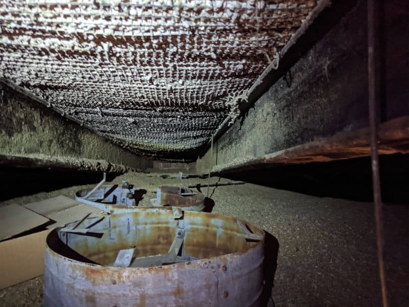

Since this popped back up and I'm seeing it for the first time, I just wanna chime in saying I love how I can find buildings using the same framing system from 100 years ago over 800 miles away. These too are "steel lumber" back to back channels
Draped mesh, yes, it looked and felt like it. Floor, no. This was attic space with flat roof above. I don't know why it would be use for a roof. The age, 1921, matches with pittguy's handbook.
I saw a draped mesh roof on a building constructed in 1960. The building is owned by my parish and the pastor wanted to knock out some walls to create a large space. I went up into the attic to check things out; first time I saw that type of roof deck. I might have a photo somewhere.
