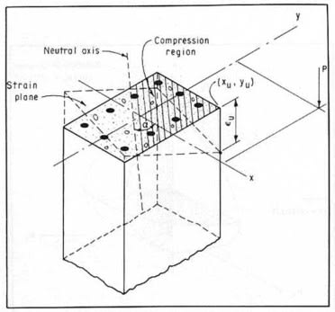

MegaStructures:
A true general section analysis involves 3 unknowns:
Start with a general strain function that assumes plane sections remain plane, which leads to a linear strain variation:
e(x,y) = A x + B y + C
Plugging in some things we know regardless of the section or stress state:
1. e = 0 at the neutral axis
0 = A x + B y + C
or
y = -A/B x + -C/B <== This is the slope intercept form of the equation defining the line of the neutral axis
dy/dx = -A/B <== This is the slope of the Neutral Axis
Assume alpha = the rotation of the neutral axis counter clockwise
Tan alpha = A/B
A = B Tan(alpha) ---- Equation 1
2. e = e,max at the compression fiber furthest from the neutral axis, call this point (xu, yu).
e(xu, yu) = e,max = A xu + B yu + C
insert Eq. 1: e,max = B Tan(alpha) xu + B yu + C
Solve for C: C = e,max - B (xu Tan(alpha) + yu) ---- Equation 2
3. Substitute Eq. 1 and Eq. 2 into the general strain function and reduce
e(x,y) = e,max + B[(x-xu)Tan(alpha)+(y-yu)]
Here the 3 unknowns are:
e,max = maximum extreme compression strain
B = equation constant
alpha = counter clockwise rotation of the neutral axis
If you define your sections using vertices and straight lines then (xu,yu) should always be one of the vertices, and it will be the vertex that is the furthest from the neutral axis on the compression side.
Relate strain to stress via material curves
That defines the strain in the general section, once you have strain then you need to apply the material specific stress-strain curves to the various sections:
For steel there is:
linear-perfectly plastic model where f,steel = e*Es for e <= e,yield and f,steel = Fy for e > e,yield
linear- with strain hardening
For concrete you have a lot of options:
PCA Parabolic-constant:
f,cip = 0.85f'c [ 2 (e/eo) - (e/eo)^2] for 0 < e < e0 and f,cip = 0.85 f'c for e >= eo
eo = (2 ( 0.85 f'c))/Ec
Hognestad's - Parabolic-Linear Curve which is similar to the PCA curve except when the strain equal eo the stress reduces linearly up to a strain of eu = 0.0038
Eurocode has a linear-constant and a parabolic-constant stress block that you could also adopt.
Perform the double integral of the stress fields to determine axial forces and moments
f(x,y) = stress functions, determined by substituting the strain function into the material strain-stress models
P = ∫∫f(x,y)
Mx = ∫∫f(x,y)*y
My = ∫∫f(x,y)*x
Note: For Mx and My be careful here with sign conventions you may need to make either y or x negative to be consistent with your chosen sign convention.
General numerical solution process:
Guess values for the three unknowns
Determine P, Mx, My <--- this step is rough, I have landed on doing piecewise integrals using green's theorem assuming all sections are defined by linear edges between vertices.
perform statics checks of your determined loads against the applied loads, everything should sum to 0. If the checks fail using your numerical method of choice determine next guess for the three unknowns. Newton-Raphson is one method but you'll need to be careful as the nature of the bi-axial problems leads to a lot of "flat" areas in the solution curve which can land you into an infinite loop with the NR method. There is also the modified N-R Method as well as some of the gradient descent methods that can take a little longer but work also.
For Single axis bending problems you then know alpha so the problem reduces in degree to a 2 unknown problem.
For single axis bending and simple shapes like rectangles the double integrals can be simplified significantly, down to mostly standard geometric formulas.
I made a quick example, hope it helps. It's the simplest possible situation, but I guess you can get the idea. It's eurocode based, but it's the same thing.

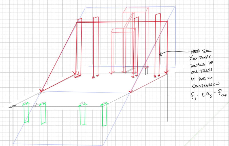

Celt83:
Great breakdown! A little bit intimidating and probably overkill for my application to actually integrate over the cross-section; I appreciate the effort you put into the post! Thanks for the reference to Hognestad's, I had the equations written down from my old class notes and did not label where they came from!
Edit: I'm actually now realizing that if I intend to use Hognestad equation for stress-strain of concrete I will have to integrate over the cross section. Pretty easy for a rectangular section I suppose.
“The most successful people in life are the ones who ask questions. They’re always learning. They’re always growing. They’re always pushing.” Robert Kiyosaki
Also for the bars in the compression region just be careful you don't double dip on the stress there, I've found it easiest to get the concrete force assuming the reinf. is concrete then reduce the actual stress in the steel by the equivalent stress in the concrete at the same location since the force from the concrete stress times the bar area is already accounted for in the concrete force.
