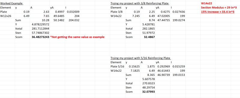

However, I ran through the worked example and I am running into one discrepency. When calculating the section properties on page 5, I am not getting the same section modulus for the compression flange, so I may be doing something wrong here.
The beam used in the worked example is a W12x26 beam, which would have an initial depth of 12.22 in. When adding a 3/8 thick plate, the overall depth d = 12.6 in.
The section modulus for the compression flange = I/d-Y
= 281.5/(12.6-4.88) =~ 36.5 in^3? The example is showing 41.9 in^3? Where am I going wrong here?

psyche - Looks to me like you are not doing anything wrong. I worked the example problem, by hand, the classical way (Statics per Beer & Johnston, First Edition - 1962). Within round off error, I got the same answers you did:
I composite = 281 in4
S composite = 36.3 in3 in the compression flange.
The author seems to take some "strange" steps and leaves out lot. I believe the example is wrong.
My calcs attached.

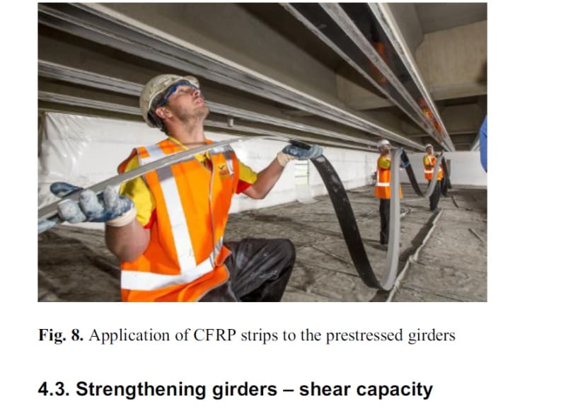

Just Add CFRP Strip with bonding epoxy [cheap - effective solution]

@SlideRuleEra - Ok thanks, I was trying to figure out what was going on. Other than a few mistakes - the document you provided is very helpful and I've included it in my reference library.
I revisited the structural model for this project and the beams were overstressed (strength) by 12%. When considering this value, I got the 3/8" thick plate to work (barely). I'll use this with intermittent welds, instead of slip critical bolts.
I'll keep the plate as A572 50 ksi to keep the yield strength values the same between both structural elements.
The shear flow for this project is quite low. The minimum intermittent weld requirements from AWS govern. Ends up being 1/4" welds, 1.5" long at 8" centers (max spacing taken as 24*thickness of the thinnest section being joined).
