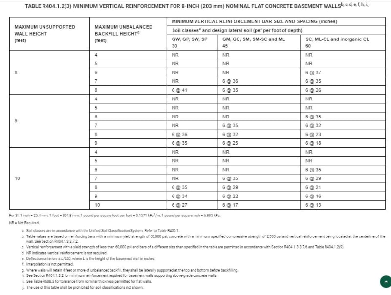

So a local home builder takes it upon himself to turn the foundation area under a covered porch into a root cellar. Nor not a big deal. However, he never contacted the engineer prior to making changes. The problem is the area under the porch floor was designed to be back filled (footings at 42”). The builder sunk the footings and extended poured concrete wall height to 8ft and no vertical reinforcement was added. The wall is 8” poured concrete with #4 bar horizontal (2 rows), doweled #4 bars from footing to base of the wall at 2’cc. I am trying to assist him with some ideas to reinforce the wall. Does anyone have ideas? I’ve thought about FRP strengthening, pouring a reinforced sister wall on the outside of the existing wall. Additionally, the porch floor and root cellar floor have already been poured. Thoughts?
