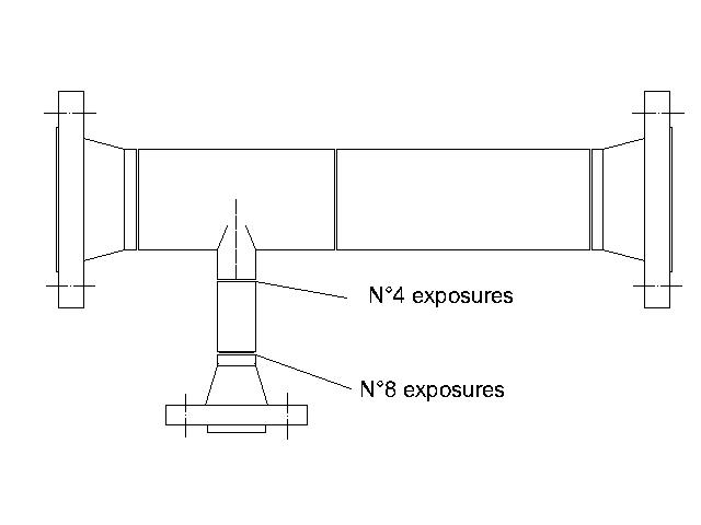

I have a vessel with a nozzle+wn flange 1" Sp.9,09mm, material carbon steel. BW weld between flange and nozzle has to checked 100% RX acc. to ASME V.
Construction code is ASME VIII DIV.1.
NDT company for this joint used double wall double viewing technique, which means, acc. to ASME V par. T-271.2 (b)(2) at least 3 exposures.
But if look at the RT report, I find N°8 exposures! Ok, 3 it's minimum, but 8... why?
NDT company only answered me that it depends on the high thickness comparing to the small diameter of pipe...I hope they did not cheat me.
What do you think? Thanks

These are the joints:
The thickness versus diameter affects the change in density on the radiograph from center to end. If there is a heavy wall, small diameter weld they were probably unable to hold the 2.0 - 4.0 density requirement across the whole length of zone requiring more, shorter zones. Kudoes to the NDE house for taking the time to check things instead of blindly shooting 3 shots and you get what you get.
JR97
Your comment is correct but it still doesn't explain why 4 shots on one and 8 shots on another.
a 1"XXS is 33.4 mm OD
Subtract 2 x WT (9.09 mm) and you have approx 15 mm.
Whether it is DWDI or Superimposed you will still be looking at both walls so 30 mm is the viewing zone per shot.
4 x 30 mm = 120 mm
Circumference of a 1" pipe is 105 mm
Full coverage of the weld is achieved with 4 x shots
