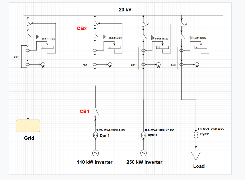

We have a 20 kV switchgear center and in one of the switchgears, which allow the injection of energy generated by an inverter, there are two 75/1 A current transformer (measurement and protection) (75 A nominal current at the primary), which are clearly oversized as the maximum apparent power flowing through that switchgear at 20 kV will be 200 kVA at most. The cables at the secondary of the CT are simply H07V-K non shielded, and all the switchgears are next to the other.
After the 75/1 CTs (there are one for measurement and another one for protection) there is a circuit breaker with a disconnector. Before the 75/1 CT there are only a 1.5 MVA 20/0.4 kV power transformer (also oversized), followed by a circuit breaker and a measurement equipment. So, summarisizing, after the inverter there is a 1.5 MVA power transformer, measurement equipment, circuit breaker (CB1), 10 m 20 kV cable, 75/1 A CTs, disconnector and circuit breaker (CB2), and the rest of the plant, in this order.
We have found 2 big issues that I would like to share with you in case you may give me a hint of what's going on.
1) When we disconnect the CB1 of the switchgear and the CB2(so there shouldn't be no power flow and current through the CT whatsoever), I am pretty sure of this), the CT still measures current. At 20 kV it is measuring 0.15 A approximately. The other switchgears are injecting current so there could be induced currents, but the 20 kV cables are shielded. If I have explained myself correctly, it should be understood that the circuit between the power transformer and the CB1 is completely isolated, and still measures current!
2) When closing both circuit breakers, with the PCS just consuming active power for their auxiliary services, the measurement equipment registers a 20 kVAr injection from the power transformer to the rest of the installation.

Could you please upload your single line diagram so that everybody gets a good idea of the problem to comment?

mls1: Thank you mls1! I have also done some research and it seems the origin of the problem must be here. I will have to check it in situ, but I am including a schematic with the connections of the CT. The PE connection is for the power supply cables.
Eduardo Diaz,
From the CT secondary wiring scheme in your message, the CT star point earthing is not done in the panel where the measuring device is located. It seems to have been done near the CT. Is that right?
The correct practice is to earth the CT star point in the panel itself. Could you verify please!

1) The +19 kVAr we were seeing in the 140 kW PCS inverter comes from a filter installed after the inverter, so we have solved that issue.
2) As for the circulating currents, we have seen the 20 kV cables go through a toroidal current transformer. These cables include the shield, and we have to confirm whether the shield is earthed at two points but it seems the most likely thing.

We were in the installation to do some tests in the 20 kV cable shields. It turned out that they were grounded at two positions:
1) In the Switchgear Centre, they were grounded.​
2) In the HV side of the 20 kV/X transformers, they were also grounded.​
We isolated the 20 kV circuit from the transformer to the Switchgear Centre, generated a high enough power flow in the switchgear cells next to them so to induce currents, and we verified that no currents were induced. So finally, we have discovered the issue.
We are now wondering what to do in order to avoid this issue in a safely manner, but at least it is identified the issue.

See RRaghunath's Oct 3 post. How are the CTs installed on the cables? To get full insulation and to exclude the shield current, generally the CTs surround the full cable; then the shield connection is routed back through the CT window before it's connected to ground.
Hi stevenal,
The 20 kV cables with the shield included are passing through the CT window, so that's the problem. I have seen that the IEEE suggest to route back the shield connection through the CT window. The only thing that just bothers me a little bit is the fact that the window is not very wide and the shield and the cable jacket would quite close.
