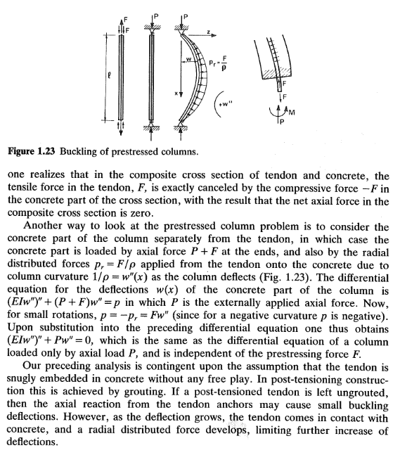

I'm not buying it BA. All of your last post works for me with one exception: you've chosen to ignore the second order load balancing effect that was the subject of your original, retracted comment. Deflection would be slightly less for the post tensioned member because, when deflected, the induced curvature in the tendons would create an upwards balancing load identical in concept to how intentional drape in suspended slabs does.
Here's some related info supporting the notion that second order balancing load effects are what keep prestressed axial members from buckling under their own prestress.

@KootK,
We still have an outstanding issue to be addressed in this thread. Concentric post-tensioning tendons in a curved prismatic member produce pure axial compression throughout the curved member. They produce axial shortening but no deflection.
When a slab is tensioned concentrically and then curved by external forces, the effect of the prestress remains the same. It is still concentric no matter what shape the slab takes. It can produce only pure axial stress in any section normal to the curved axis. Deflection produced by external forces does not result in any load balancing by the tendons.
BA
What BAretired is stating (curved beam with concentric presterss = only axial compression) was what a professor friend of mine (Dr. M. Tadros - U of Nebraska Omaha) some years ago.
I had a hard time getting my head around it but I think he (and BAretired) is correct.
faq731-376
@BAretired/JAE: are neither of you swayed by the column information that I posted above which, in my opinion, clearly shows the effect that I've been espousing? It's from Bazant for goodness sake. You'd be hard pressed to find a more reputable, living source.
A curved tendon, curved by way of drape or deformation, has components of it's tension oriented vertically. Obviously. If those components don't push upwards against the encasing concrete, then what keeps the cable in vertical equilibrium?
