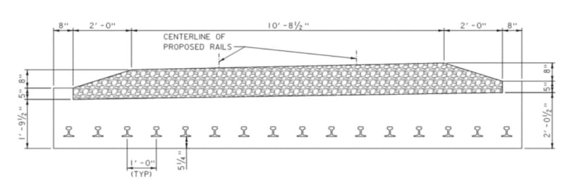

structeng24 - Can you post a crossection (sketch is fine) showing "steel rails near the bottom of slab"?
Are the rails partially embedded in the structural concrete, or are they installed in "pockets", so that top of rail in more or less level with top of slab?
Often rail installation/maintenance is completely independent of bridge construction.
I would never consider the rail to simultaneously be stressed as part of a bridge's structural support system and carrying full load from a moving train. Rails typically flex visibly and move around quite a bit as a heavy train passes over them.

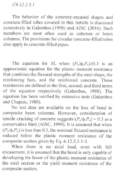

I too would like to see a photo of the cross section as the rails being near the bottom of the slab sounds strange. Relying purely on concrete adhesion to the steel to justify composite action when no mechanical anchorage is present raises many questions. However, this sounds like something I would be faced with when load rating an old bridge.
AASHTO typically considers concrete encased structural steel shape members for columns or beam-columns. A purely flexural beam/slab is (IMO) not the intention of AASHTO. They do have some commentary under section C6.12.2.3.1 that seems to sort of address the topic but rather briefly:
Thanks for the responses. The cross-section looks as shown below. The section of AASHTO MBE that I'm referring to is 6A.6.9.4, which deals with concrete encased steel I-sections in bending and I think this is similar to that.
structeng24 - I have not come across that design. Because of their size and location, appears the embedded rails will perform more like rebar than embedded I sections. But, you have to start somewhere... suggest making the calcs you have proposed to see what you get. Based on the results, you probably can make a better informed decision on what to do next.
Edit: Just noticed that the slab is not a constant thickness. What's that about? Superelevated on a curve?

correct, it's super-elevated on a curve
