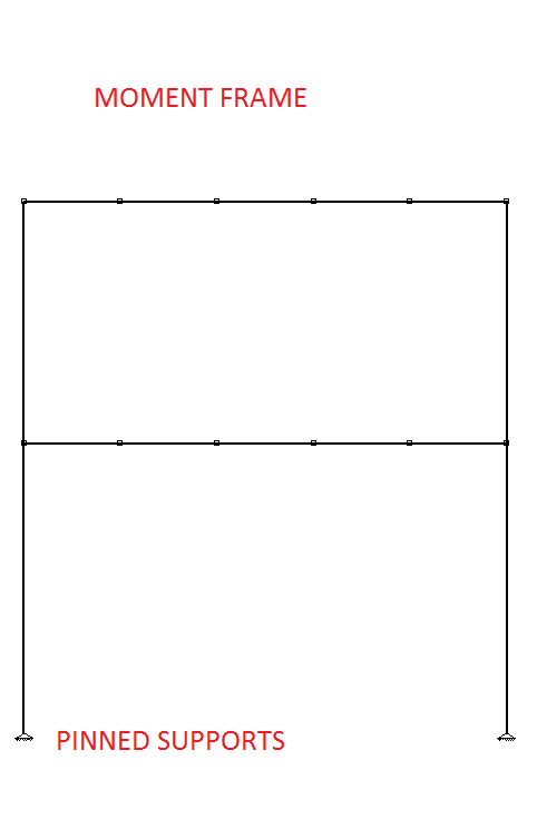

Greetings, I have a question about pinned/fixed supports.
Let's say we have two moment frames and I modeled column's supports as pinned. Because of that I have designed a footing to axial forces only.
Now contractor made them fixed (based on detail bellow). As I know this means that footings will also see moments from the end of the column since supports are fixed which means footings should be larger.
Since footings are not sufficient for fixed connection, how will this act in real life? Will footings rotate and the system will act as pinned supports?
First thing to recognise is that your 'pinned' supports were never 100% moment free to begin with. This is a engineering slight of hand that is helpful for modelling but assuming zero moment can be dangerous. (Though much of the time there may be sufficient moment resistance even if it wasn't designed for it.)
If the footings are generally not sufficient to resist the moment then yes, by your own assessment they will rotate if faced with design loads.

In real life, there is no such thing as a perfectly pinned support. Likewise there is no such thing as a perfectly fixed support. You're always somewhere in between.
To determine how much moment gets into those frames, you could model the support as a rotational spring. What I've done in the past is look at a "unit" rotation of the footing and seeing what sort of pressure that creates on the footing (based on the soil's subgrade modulus). In this case, I assume the soil capable of resisting both tension and compression.... not reality. But, it should still give me a pretty good starting point for my rotational spring. Maybe it comes out a little closer to "fixed" than it should.

With pinned ends on a moment resisting frame you tend to have lateral shear forces at the column base that tend to rotate your foundation.
Look at it this way: your members are bigger because you designed them as pinned. So your system is stiffer as before. Base connection is not rigid, foundation can rotate... But still stiffer as calculated in the beggining. I would model my foundatin with like a slab with a small soil subgrade modulus. You will see how it behaves. Watch out for tension under foundation or run non-linear analysis with tension disabled.

Footings will rotate but not enough to act as pinned supports. Footings need to be checked to ensure they are adequately sized and reinforced to resist a reasonable moment based on probable soil stiffness. This is not an exact analysis, so engineering judgment is required.
