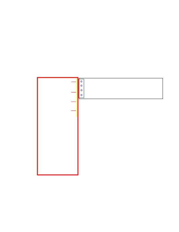

I have a condition where steel girder attaches to concrete pier. The steel girder has a tremendous shear load, in the range of 600kips factored.
The steel girder is a W36 which spans into concrete pier which is 6'-0" x 4'-0" x 10'-0" LG.
I tried using a embed plate with studs for the connection, but as the shear is too high I cannot make it work. Shear breakout and prying is an issue. Is there another way to attaching the beam to pier?
It can be done... can you make it a bearing connection? If not, a cast in plate with headed studs and clip angles welded to it.
Agree with Dik, make a bearing connection. Perhaps by creating a "pocket" in the concrete pier.

There is a building column on top of the pier with significant axial and moment loads. I don’t want to create a pocket in the pier for bearing type connection.
The cast in place plate with headed stud, I am not able to get the shear breakout to work
Did you investigate using a shear lug welded to the back of the plate?
For a 600K load you might need a little more than a shear lug...
675 kip, 4 - 18"x6" deep lugs, 16" o.c., 5 ksi concrete Maybe not the best solution but its a start. The embed plate can always be lengthened to provide locations for the shear lugs.

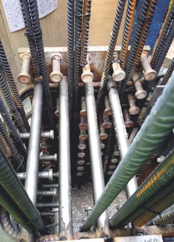

Another option might be to bury a steel section within the column.
is this an existing or new condition? If this is a new design are you able to drop the bottom of the column down so the new beam frames into the steel column so it's just a base plate anchorage condition?
If it is existing, can you add a new pier outside of the existing to create a bearing condition for the new beam? Or add a concrete corbel (may run into similar capacity issues).

I think you need to lower the top of pier elevation so that the girder can frame into the steel column near its base.

4 x 5 array of 1" (Ø25mm) shear studs could work.
Yeah, I think dropping the column is the most viable solution.
pvchabot said:
do you have an example for the embedded steel in concrete like you are suggesting
