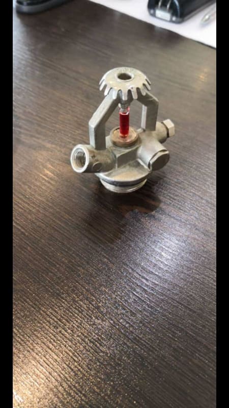

Jan 5, 2019 #1 crb7 Mechanical Joined Jul 4, 2018 Messages 47 Location FR hi guys can u tell me, what kind of sprinkler is this?
Jan 5, 2019 #2 cdafd Specifier/Regulator Joined Aug 18, 2005 Messages 2,953 Location US Any markings on it ? Upvote 0 Downvote
Jan 5, 2019 #3 cdafd Specifier/Regulator Joined Aug 18, 2005 Messages 2,953 Location US Is there an opening on the bottom??? Like a normal sprinkler? Maybe some type of marine application? Possibly not made in the USA Upvote 0 Downvote

Jan 5, 2019 #4 Cidona Mechanical Joined Oct 21, 2007 Messages 147 Location IE I think it might be a Multiple Jet Control Valve. Similar to one link this http://www.fireguard-uk.com/products/sprinkler_systems/multiple_jet_control_valve.htm Upvote 0 Downvote

Jan 5, 2019 #5 cdafd Specifier/Regulator Joined Aug 18, 2005 Messages 2,953 Location US Interesting http://www.fireguard-uk.com/pdfs/multiple_jet_control_valve.pdf Tyco has one https://www.tyco-fire.com/TD_TFP/TFP/TFP1346_10_2014.pdf Upvote 0 Downvote

Jan 28, 2019 #7 Jon.M Civil/Environmental Joined Aug 28, 2017 Messages 8 Location US this is a hanging automatic fire extinguishing sprinkler. goes on top of a fire extinguisher. used in Asia mostly. Interesting find! https://files.engineering.com/getfile.aspx?folder=5878c2c4-9fc2-4f72-8009-1a24ee9b0d6e&file=automatic_extinguisher_valve.jpg Upvote 0 Downvote
Jan 28, 2019 #8 cdafd Specifier/Regulator Joined Aug 18, 2005 Messages 2,953 Location US Jon.M (Civil/Environmental) 28 Jan 19 14:07 this is a hanging automatic fire extinguishing sprinkler. goes on top of a fire extinguisher. used in Asia mostly. Interesting find! https://files.engineering.com/getfile.aspx?folder=5878c2c4-9fc2-4f72-8009-1 I have seen them here in the great USA, mainly used for drop boxes, or safes Upvote 0 Downvote
