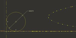

That is working out pretty well but there are some things about VSS that I don't understand.
If I make my sketch centered on the trajectory cross hairs, it behaves itself quite well.
View attachment 6396 View attachment 6397
However, because I am anal about using part dimensions in my drawings, I want to offset the circle so the trajectory is the OD of the spring.
However, I must need some kind of normal or tangent control because this causes the sketch to "orbit" around my trajectory so that the areas where the trajectory has constant diameter, the spring is "bee hived".
I can't seem to figure out how to use the X to T controls to make it behave.

could you post the model and graphs so I could look at it and play around with it? I am not sure if you will get what you want because your sketch would have to wrap around the curve to stay as the OD of your spring.
Here is the file with the sketch centered on the trajectory cross hairs. I would have thought that if the normal follows the trajectory then if the section is offset to the outside than it should always stay outside as it follows the trajectory.
Actually, I think I've got it. I changed the section plane control from normal to trajectory to normal to projection and selected the bottom (datum 2) as my direction reference.

what I meant about wrapping around the curve is that your wire sketch is on the top of the curve at the bottom of the spring therefore it will be on top of the curve at the top of the spring and your overall dimension will not be correct if you show dimensions in your drawing because the dimension will go to the bottom of the top wire (if that makes sense). You may have to bite the bullet and create your overall dimension for this one.
