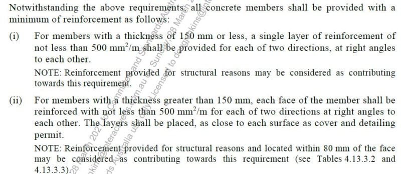

From the Australian Bridge Code (AS 5100.5):
I haven't checked the Eurocode, but when I worked in the UK it was standard practice to reinforce the top face of all footings for bridge structures.
Doug Jenkins
Interactive Design Services
