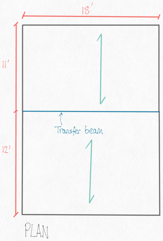

I'm working on a project, where I have designed a transfer beam that has slabs tying in to it at two different levels.
Dimensions are shown below :

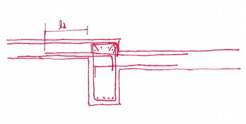

My preferred detailing for this is to hook the upper slab top bars in the beam and the bottom bars of both slabs in the beam. I extend the lower slab top bars through the beam and give a development length past the slab. See below.
@RobertHale, Thank you very much your response is very helpful. Designing as an L beam seems reasonable to me and should be a more efficient way of designing the section (instead of a rectangular beam).
In reality I believe the slabs will act as two way slabs, however for simplicity with hand calcs, I designed them as one way (all load assumed in the shorter direction) see below :

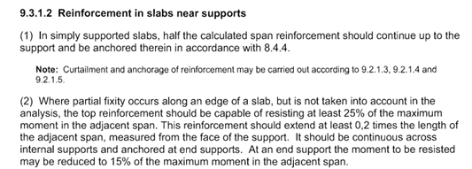

I also provided minimum area of steel required for temperature/cracking as distribution bars in the long direction and included hogging reinforcement at the top near the support as per EC2 9.3.1.2(2). I used 25% of max bending moment as per EC2:
In hindsight, I'm not sure if this is a suitable approach to try to "force" one way bending for a slab with a ratio of ~1.5 (less than one way allowance of 2), so I'll also check the slab as a two way panel with supports on 4 sides (not continuous) in TEDDs or something to make sure the cracking distribution bars specified are adequate.
You mention if "they are one-way slabs, I don't consider continuity". Would this differ if they are two-way?
