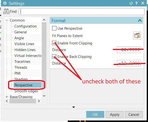

I'm trying to create splines in a view in a drawing (NX 2007) and when I exit the sketch and update the drawing they disappear. After playing around and erasing the part in that view using View Dependent Edit, I found the splines. They are behind the part in the view. Didn't even think that was a thing. How do I get those splines in front of the part within the view?
I assume it has to do with Clip Planes.

I hope this is the issue.
RMC on drawing view and go to Settings.

I am not aware of a simple solution to this issue.
The strange thing is that when creating a sketch in a drawing view, there is no way of defining where in "depth" that sketch will be created.
Report this as an issue to Siemens.
