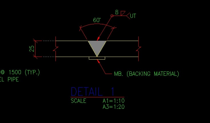

Thanks all for your comments. Today I've got the welding detail form the contractor as shown below. Any idea for this? Is it a good practice for CJP?.
The sketch should come with a written procedure... then OK.
The contractor should also show the the root opening. If you're following AWS D1.1 or D1.5, the opening is 1/4" +1/16, -0.

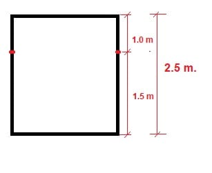

May I ask for more information? If the steel plate is not 2.50 m wide (crossbeam cross-section size), can we weld two plates of 1.0 + 1.50 m together?
Similar to previous answers, there's no reason you can't do a longitudinal weld - it's not much different from the weld to the flanges. Provided you've done the checks for fatigue / fracture tolerance of the final structure, have an appropriate weld procedure, and have an appropriate temporary works procedure you should be OK.
However at least in AUS, plates with widths >2.5m are easily available. Are you sure you need to do a longitudinal weld? It will likely add significant cost and significant risk of defects and rework, compared to the cost of sourcing a plate of the right size. Weld shrinkage could result deformations of the web plates which could be a buckling risk or at least very unsightly, or require additional stiffeners and rework to address. If you plan to do the splicing after the rest of the fabrication is complete, any internal stiffeners will also need to be welded up as well, or otherwise a new stiffener detail developed.
