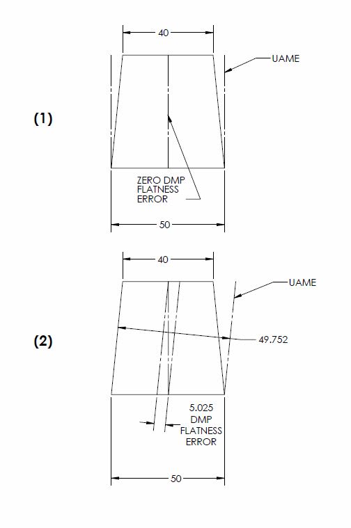

Parallelism between the surfaces shown in fig 5-8 / ASME Y14.5-2009 is controlled within:
a.) 0.11
b.) 0.08
c.) 0.02
d.) 0.04
e.) 0.15
f.) 0.07
g.) None of the above
Edit: maximum allowable parallelism between the two surfaces dimensioned with 16h11 (15.89 - 16.00)

For question 1, consider a cross section consisting of a polygon with the following vertices:
[pre]
P1: ( 0.000, 0.000)
P2: (17.520, 0.000)
P3: (52.560, 0.110)
P4: (52.560, 16.000)
P5: ( 0.000, 16.000)
[/pre]​
Datum A is derived from the segment joining P2 and P3. Datum B is derived from the segment joining P4 and P5. I calculate parallelism of about 0.1650 for datum feature B, parallelism of 0.1100 for datum feature A, and DML flatness of about 0.0183.

3DDave said:
chez311 - and I missed the link to the UAME in the median plane definition - live and learn. I do think that this is not well thought out in the standard, as most examples
Looks like the answer is not very straight forward. I guess we cannot pick without reasonable doubt one answer versus the others.
I will go back a little bit to the definition (as suggested by 3DDave) of the derived median plane flatness – RFS- and I have noticed that 2009 standard states -- same fig specified by the OP in the original question -- Fig. 5-8 page 94
“The derived median plane of the feature’s ACTUAL LOCAL SIZE must lie between two parallel planes 0.04 apart ……..”
The new draft of Y14.5 removed ACTUAL LOCAL SIZE from the text.
New draft: "The derived median plane of the feature shall be within two parallel planes 0.04 apart ……."
I don’t think this is a change in definition, but more like a clarification and I don’t think that will change the outcome of the question posted here (whatever the answer is going to me be).
Am I correct?

The way you designed the original question has very little to do with the statement given in para. 5.4.4.1 of Y14.5-2009:
"Where the straightness tolerance is used in conjunction with an orientation tolerance or position tolerance value, the specified straightness tolerance value shall not be greater than the specified orientation or position tolerance value.”
This statement applies to situations where a position and/or orientantion and straightness feature control frames are associated with a size dimension (for example see fig. 6-9 and imagine that additional straightness FCF is added). Per the statement the value of that additional straightness tolerance could not be greater than 0.2.
Unfortunately that statement is incorrect because a feature of size may have significant DML (or DMP) error and at the same time its axis (or center plane) may be perfectly oriented and located with respect to the specified datums. It is because in ASME feature's DML and axis (or DMP and center plane) are totally different animals.

3DDave,
ASME Y14.5.1M-1994 para. 4.3.2 (a) said:
The candidate datum set for a nominally flat primary datum feature is defined by the following procedure:
(1) Consider a plane P which is an external set of support for the datum feature. Let C be the set of contact points of the datum feature and P.
(2) Consider an arbitrary line L in P. Orthogonally project each point on the boundary of the datum feature onto L, giving the line segment L’. Consider regions of L’ that are within some fraction x of the endpoints of L’. That is, if the length of L’ is n, consider regions of L’ within a distance xn of the endpoints of L’. Unless otherwise specified on the drawing, the value of x shall be 1/3. If all of the orthogonal projections of the points in C are within either single region, then plane P is rejected as a valid datum plane.
(3) Do this for all lines in P. (Note that parallel lines will yield identical results.) If no line rejects P, then P is a candidate datum for the datum feature.
I'm really only thinking about this question in two dimensions, so there is only one line L to consider.
