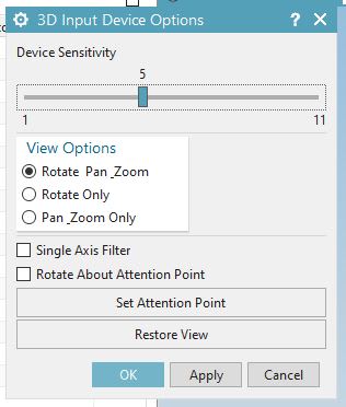

Has anyone had any luck getting a spaceball to work with remote login? Using Pulse Connect Secure to login to work computer from home. I have a SpaceMouse Compact at home and at work.

The driver is already running on both machines. Actually the spaceball does work right now, but it will only zoom in/out. It will not rotate.
You could have accidently turned off rotate by pressing one of the buttons on the Spaceball. You can fix it in NX.
Preferences -> 3D Input Devices

No... its not simply a matter of changing the NX preferences.
The SpaceMouse doesn't work over remote desktop because the windows signal being sent is the same as a mouse wheel.
thats why all you can do is zoom in and zoom out.
they really need to make some kind of a fix for this but it's down to 3Dconnexion and from what I've learned, their technical support is...not great.
all they will tell you is "did you try reinstalling the driver?" which as we all know does nothing.
