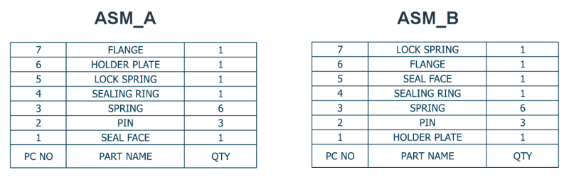

Another question pops in mind is about ordering part list items. For example I have two assemblies, ASM_A and ASM_B. first I created components of ASM_A and then built it. Then I created ASM_B Components that they are versions of ASM_A Components. There is some differences in dimensions and some geometries. But NX applies different order in parts list items for ASM_A and ASM_B drawings.
Is there any way to change parts list order(PC NO) to create same numbering for similar components?
The PC NO is in the attributes of the components. Do you run teamcenter? If you right click on a component in your assembly, find the callout attribute the number in this attribute hopefully matches the PC NO in your parts list. Change these callout numbers to be consistent between the two assemblies. Hope this helps.
There are "two" ( Three) options, either you manually set the attribute "Callout" to a specific number, or You use the Sort option ( Right click -Sort) on the partslist and let NX do the work.
We have a specific attribute "item class" which we use to 1:st sort , - fabricated by ourselves, bought items , fasteners etc
2:nd sort is item ID. Note that the sorting option allows you to sort on a number of columns but NOT the PC No, that column will be the result of the sort.
3) You can let Teamcenter dictate the PC no by setting the callout number.
Regards,
Tomas
