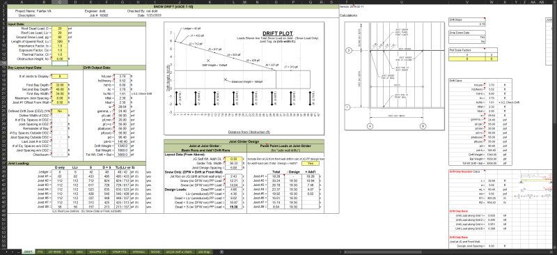

As for the side walls where the joists are parallel to the wall and each joist away from the wall gets smaller uniform drift load...Yes we actually calculate the load on each joist up near the wall (I call it the drift zone). In fact, I calculated it so much that I made myself a handy spreadsheet. Nice and dynamic like...
edit to add pics
drift spreadsheet - DDZ
drift spreadsheet - no DDZ

Cool spreadsheets sold. I used to have a similar thing in MathCAD but nowhere near as well done.

Those are some nice spreadsheets dold. Yes, what you described is what I had in mind. If I remember correctly (not very sure), Canadian code recently allows up to 10ft and snow drift on roof top units can be ignored. I still think i makes sense to consider drift snow loads around rtu's.
