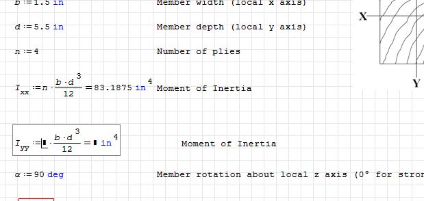

I'm learning SMath on the PC and I'm having trouble deleting an empty placeholder in a formula. I read that I should just be able to empty the contents of the placeholder and then shift-arrow over the blank placeholder and then back space, or double backspace, to delete it. I've tried several combinations of those actions to no avail. I am left with a placeholder that prevents the formula from completing. I will just write the whole thing over but I'm thinking there is a direct way to make the change.
Reference the black square near the beginning of the Iyy formula.
Edit: Also I have decimal places set to 2 for calculations but as you can see Ixx is still reporting to 4 places. I'm not sure why. It looks like all new formulas are reporting to 2 places.

I can delete empty placeholders when they are on the right end of the equation, but not when they are on the left end. I just copy/paste out the part I want, get back to one placeholder, and paste it in there.
It seems to me that the decimal place issue happens when you copy/paste -- seems that messes up the decimal/exponential settings.

I think you need to delete the operator as well to get rid of the placeholder. Also try the Insert key, it used to change the facing direction for deleting.

Had the same problem. Figured it out already. Not obvious, especially to a Mathcad user like me.
I don't think Insert key works the way it did in Mathcad.
First, you have to move the cursor until it brackets the term on the RIGHT that you want to keep. Bear with me...
Make sure that the vertical cursor line is on the LEFT side of it.
Press the BACKSPACE key. 3 times, I think.
As for the decimal places, IME the OPTIONS setting box has no effect except during the moment you create the new blank sheet. It will become the default for that sheet, whatever it was when you created it, but if you change it later, nothing will happen. Nothing predictable, that is.

@SparWeb I'm kind of impressed. I was pretty sure I tried every combination of Del/Backspc/Arrow but your steps worked to delete the empty argument. Actually, just a single backspace seems to work if you put the cursor in the right location as you describe.
With the decimal places it looks like you have to retype the expression to update the number to match the settings. Even copy/paste of the entire sheet into a new sheet does not reset it to the settings of the new sheet.

I often place my result "x=#" in a column or a group. This is for readability, but it also allows me to box-select them all and then right-click to change properties of all of the fields. I can change the trailing zeros (check) and decimal places. That, at least, gets all results doing the same thing. Later I can pick 1 at a time for specific adjustments of appropriate decimal places.

You can set the decimal places of individual expressions by right-clicking on them.
