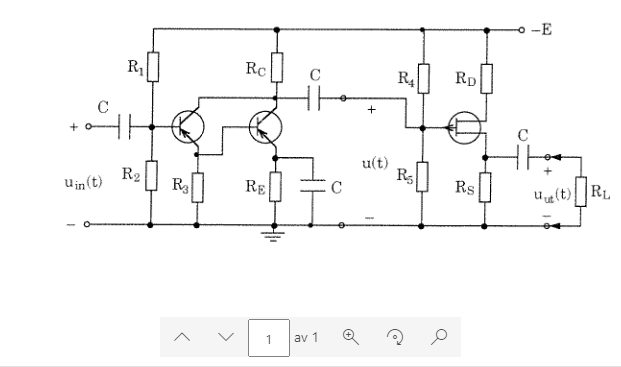

Small signal model of circuit with Darlington pair and source follower.
David312
Student
Dec 12, 2021
3
I have some issues with drawing the small signal model of the circuit (picture 1.) I get confused when there are multiple transistors, especially when they are linked together like the Darlington pair.

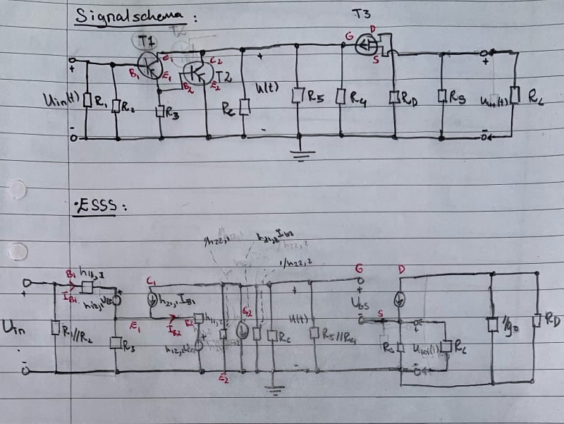

This is the attempt I have made so far.
Could someone tell me if the redrawn circuit is correct?
Doesn't look right to me.
-E is not the same as "-"
There are no capacitors?
-E is a negative supply, which is what's needed for a circuit based on PNPs and a p=channel JFET. It should have been pretty obvious that something like R4/R5 is clearly a resistive divider, so paralleling them should have raised a red flag.
And, as itsmoked indicated, you seemingly removed all the capacitors, which would nullify your schematic for determining gross frequency response.
TTFN (ta ta for now)
Hmm, now I am confused. I have followed my examiners' example when he did it for a circuit with one transistor. He says that one should do it as following: (1) ground the "-E" (2) capacitors short-circuited(3) Put in the small signal model for the respective transistor. That is what I have done here and is why for example R4 and R5 is parallell (both are connected to ground and to eachother). This is just a introduction course. But, if we dont look at the capacitors, is it still wrong?
Im sorry I did not explain it earlier, but it states in the assignment that C is large, and therefore not used.
