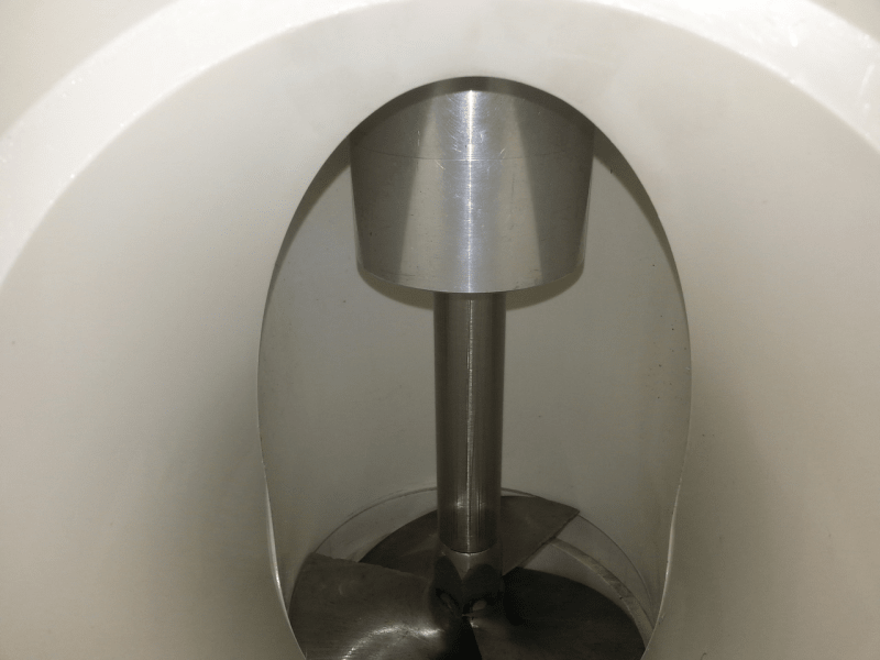

This may be the turbine runner.
Bill
"Why not the best?"
Jimmy Carter
So a reverse axial pump.
Looks like a Kaplan turbine.
