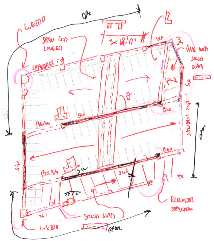

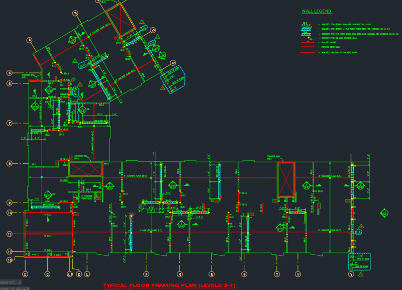

I'm doing a feasibility study on a small parking garage:
- 200' x 200'-ish.
- Two levels above grade.
- A rectangle if possible, a parallelogram if not.
- Coastal, high seismic (I'm not worried about this part).
- Precast TT and spandrel if the numbers make sense, mildly reinforced CIP if not.
My questions, which I'd like to have considered separately:
1) How viable is a parallel shaped parking structure like this in precast? I've had the good fortune to only EOR these things a sexy rectangles thus far. Can the ends be skew cut like I've shown? Got any better ideas for layout, especially at the top right? whatever I do will have to make sense for drainage.
2) How viable would a rectangular parking structure this small be in precast? In my home market, precast usually comes out on top for anything of any appreciable size. This one is pretty darn small however. At some point, I'd have to think that there would be so few precast pieces that the scales would tip in favor of CIP.
Parallelogram shaped DT's can be cast but would require custom end separators which are typically made form steel and would drive the cost up given the small quantity to amortize the cost over.
The corner columns would require some thought and custom forming but they are typically not prestressed so that could be managed.
Seismic should not be a problem. I recently completed a 4-story all precast parking garage 180'x 116' in Oakland which had less shear wall than you are showing.
They did the Montreal olympic stadium in precast (...they really shouldn't have); if you have 'big pockets', this could be done... I'd likely do it in CIP...

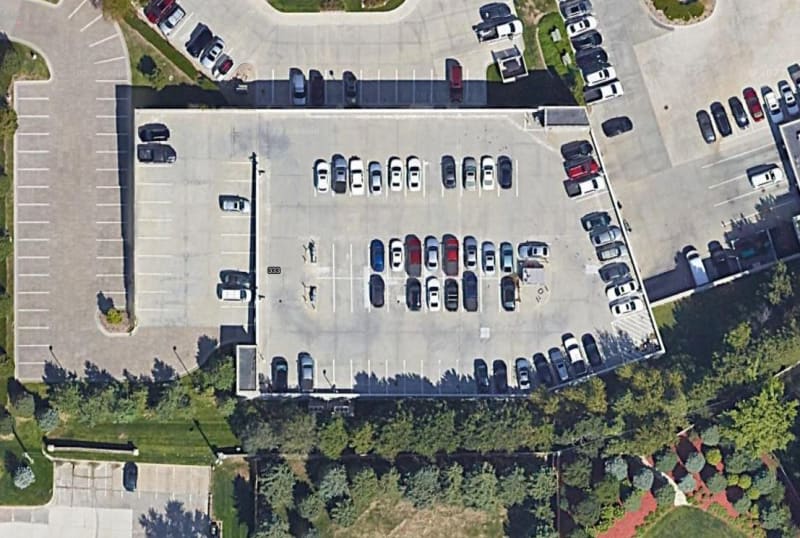

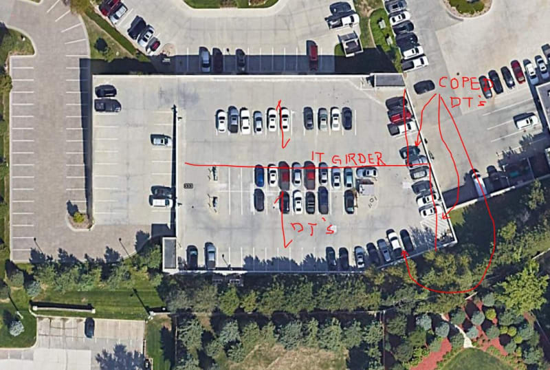

I did a auto-dealership service garage with a rooftop parking area that had a severe wedge shape on one end.
(see the attached arial image).
The left side was a ramp (on EPS Foam Fill) going up to the upper deck. All double tees supported by inverted "T" beams.
The left side, as you can see, was a nifty rectangle shape but the right side had an angular end. They simply coped off the DT's as required and
provided support ledges along that eastern (Right side) wall.
We did take the time to visit with a precaster ahead of time to verify that at least one precaster could handle it.

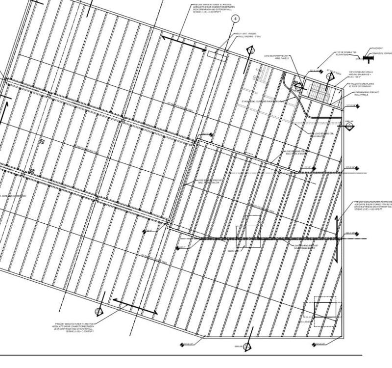

Here's a more accurate framing plan.
The area with the doubled DT's is due to us shallowing up the DT's because there was a mezzanine below that area and we needed all the headroom we could muster.
I'd line up the planks like what JAE is showing instead of making each precast piece a parallelogram.
That's one I did. Not a parking structure, but the top area had slanted planks. Zero issues with the fabrication.

They simply coped off the DT's as required and provided support ledges along that eastern (Right side) wall.
"coped" = blocked off the ends of the TT forms somehow, right? Your skew ended TT weren't saw cut after casting etc?
Yes - the ends of the TT were at an angle

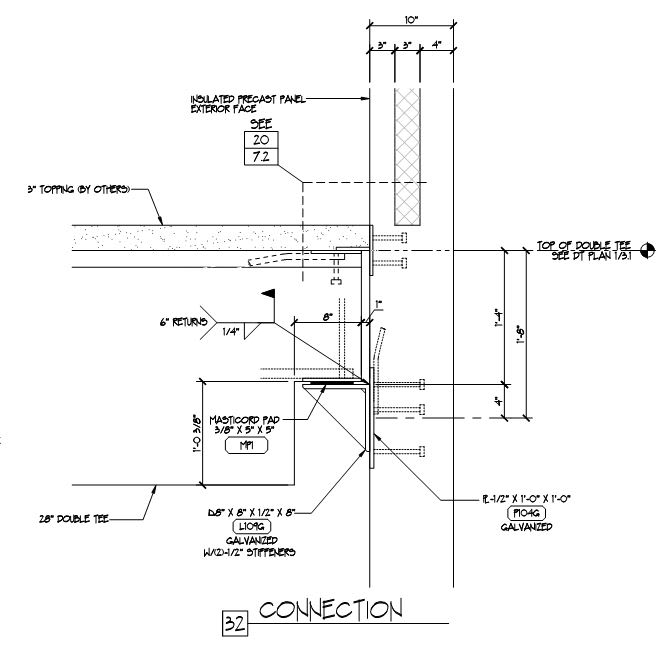

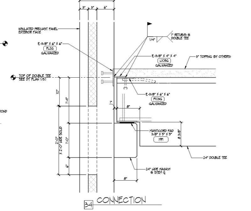

The wall side of the connection I've got a bead on. What I'm wondering about is the TT side of it. You know, there's usually a bearing plate / DBA setup in there, sometimes with a very small dap of sorts. Maybe some HWS. Still got those? Are the plates still square or were they cut at an angle to suit the skew on the TT end? Perhaps this is more detail than you got into as the EOR. I did some hard time as a part time precast engineer so I'm a bit sensitive to the details.
Most didn't have daps in the DT's. Only where we were trying to keep headroom high we dapped the DT's and I think used steel angle bearings.
Otherwise simple embed plates on the bottom of the DT stems to allow a welded connection to the corbel bearing plate (embedded in the top of the corbel).
I'm not sure whether square-to-the-world or skewed embed plates - can't recall and the shop drawings we have appear to show it.
Yes - we didn't dictate those kinds of things.
OK - so I guess there were conditions where they dapped the DT's more often than I recalled. Here's a couple of generic connections they used.
It seems like others have covered the issues with skewed ends fairly well, and what I've seen would support what's already been stated on that subject.
I would just add that what we've seen in cost comparisons is that proximity to a precasting plant, and whether those nearby plants hve the forms for the sections you want to use, has a significant influence on the total costs. Transportation costs (for us at least) are a significant percentage of the overall costs.
Your job wouldn't small compared to the bridges we do, which are typically in the range of 50' x 100', and some smaller, and prestressed is regularly competitive with steel plate girder systems. Most of ours are decked bulb tee sections, though. We do some tri-deck (triple Tee) sections for spans under 60'.

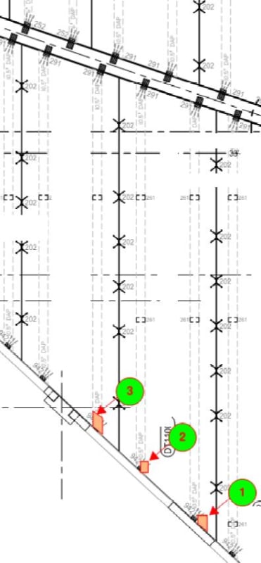

I'd be tempted to keep the tees normal to the shear wall as best as possible to avoid the torsional stresses on the double tees (adjacent stems will have different deflections). For the triangular areas, frame with an L beam and flat slab wedge pieces.
Bearing plates can be either rectangular or odd shape.
Double tee stems do not have to follow skewed line of the flange,
which could reduce bearing area.
That's how typical or simple stem end form can be used.
