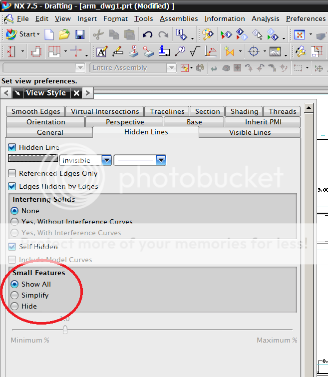

Oct 1, 2013 #4 JohnRBaker Mechanical Joined Jun 1, 2006 Messages 38,203 Location US Here is the setting that you're looking for: John R. Baker, P.E. Product 'Evangelist' Product Engineering Software Siemens PLM Software Inc. Industry Sector Cypress, CA Siemens PLM: UG/NX Museum: To an Engineer, the glass is twice as big as it needs to be. Upvote 0 Downvote

Oct 3, 2013 Thread starter #5 jerry1423 Mechanical Joined Aug 19, 2005 Messages 3,428 Location US Thanks for the replies. I get the attached arror, even after trying a few differnt settings. http://files.engineering.com/getfile.aspx?folder=4fba2adf-4f56-437d-976c-6b95f6210a6b&file=error.JPG Upvote 0 Downvote
Oct 3, 2013 #6 JohnRBaker Mechanical Joined Jun 1, 2006 Messages 38,203 Location US You might also want to make sure that on the... Customer Defaults -> Drafting -> View -> Threads ...page that the 'True Hidden Line' option is toggled OFF. John R. Baker, P.E. Product 'Evangelist' Product Engineering Software Siemens PLM Software Inc. Industry Sector Cypress, CA Siemens PLM: UG/NX Museum: To an Engineer, the glass is twice as big as it needs to be. Upvote 0 Downvote
