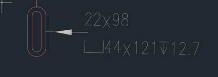

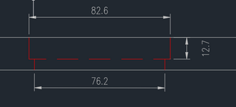

Does anyone know if there is a correct way to denote a slotted counterbore? I've made these drawings based on what I think is the correct notation for slots and counterbore. I also added a cross section of what I'm trying to convey. Don't mind my rounding. I know I should just use the cross section but I want to get peoples thoughts on the views without the cross section. Thanks.
Edit: Should clarify that the 4x is to indicate that there are 4 of these slots. I have noted the full length and width on a different slot so that the drawing doesn't get too busy in one place.

A typical slot is full width X full length and an indication of 2XR to indicate a full radius (not necessary to use "FULL") for ASME Y14.5.

So I've done this on a separate slot already (ignore how messy it is) but how do I indicate the counterbore information? I was trying to work it into the 2XR as I don't see how else to include it in a clean way.

You can do 44 X 121 (depthsymbol) depth dimension with a leader to the slot outline. If this is Creo then create a note with a leader and use the width and length and depth dimensions in the note to keep it parametric. The "2X R" is a separate note with a leader; it should be an allowable modifier to be radial, but that's not required.

Do you think this note would make sense? I'm using the counterbore format for a hole but swapping radii with slot dimensions. The smaller part of the slot being the upper dimension and the counterbore being the bottom dimension. Would this be clear on an engineering drawing? Thanks for the help.

Give it a try. At the worst you will end up with a section through the slot to put the depth dimension on because someone will be all put out.
Remove the diameter references. There is no full diameter and that is not what is being dimensioned, the width is. This is why the standard shows the R callout separately.
A section view will also explicitly define which side the cut out is facing.
So, when (not if) the mistake is made by production, you can point at the section view and show it to your boss.
