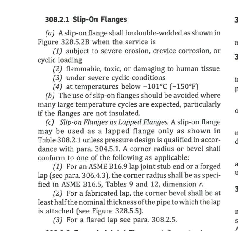

Is it a good practice to use slip on flanges for normal fluid services for flange rating 150# instead of weld neck flanges to save cost?
Would you recommend slip on flanges for steam service of 10 bar and 30 bar pressure?
ASME B31.3 also states that slip on flanges can be used where severe erosion, crevice corrosion is expected and for toxic, flammable services as well if double welded.
ASME B31.3 2022
K308.2.2 Other Flange Types. Slip-on, socket welding,
and expanded joint flanges, and flanges for flared laps, are
not permitted.

I'm on working with Category D and Normal service fluids. K308.2.2 is for High pressure Fluids if I'm not wrong
@ Xk333
What edition of ASME B31.3 are you using?
Regards
r6155,
ASME B31.3 2022 page 35
