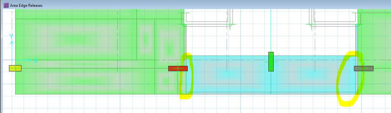

Guys, may i know how to assign slab edge release in SAFE ? I have exported the model from ETABS into safe to design the slab.
Say that I want to release the edges at the yellow junction only. How to do this ? When I choose slab edge release in SAFE , it automatically release at 4 slab edges , which I dont want. I only want to release moment at certain edge only.
All you should have to do is select the edge you want to release (and only that edge), then use the Assign - Slab - Edge Release command.
My guess is that you're selecting the whole slab instead of just the edge you're interested in.

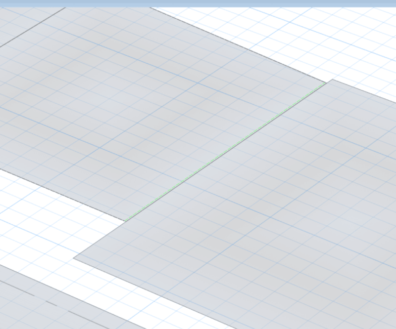

Sorry to revive this thread. I found your method worked somehow. However, is there any better way than this ? Becuase in as you showed in teh diagram, the selected line (shown in green) is barely visible. I have used draw a line and try to release the slab edge moment using the line released command, sadly it doesnt work ... Do you know why ?
I will be exporting the slab to SAFE from Etabs to design the slab only. Is it necessary to assign slab release in Etabs or I can just do it in Safe since I use the Etabs to design beam and columns and SAFE for slab design only... Does it affect the results of beam much in Etabs if I doesnt assign slab release properly in Etabs?
dccd -
I agree that the line can be difficult to see sometimes. It's probably worse for people who have a tiny bit of color blindness.
Sometimes it helps me when I vary the graphics mode from Standard to Direct X or such. Sometimes it helps when I look at it in a different view (plan vs 3D). Or, maybe if I switch from a white to a black background.

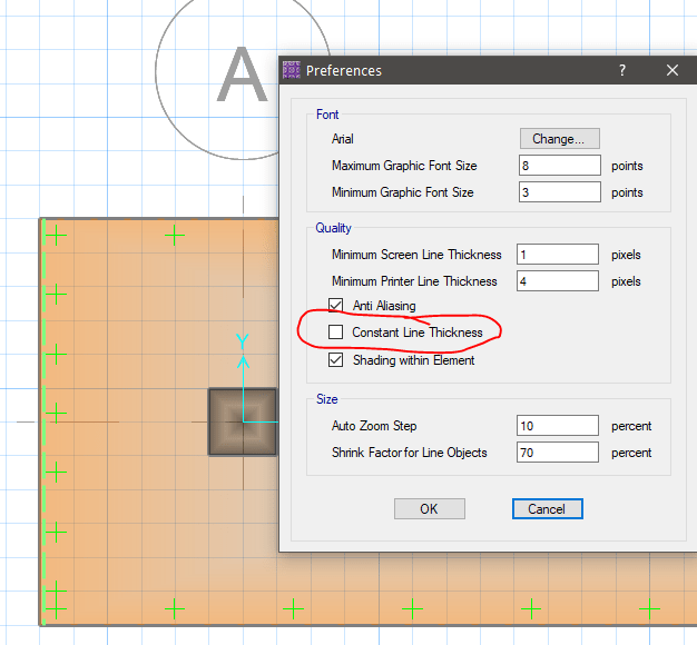

I like to change the colors of slabs from the dull grey default to any color of your choice. I picked orange and feel like the selected edge "pops" a little more.
Also, removing constant line thickness makes the line really pop:

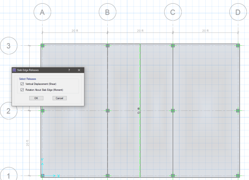

Just so we are on the same page, I am referring to this button, slab edge release:

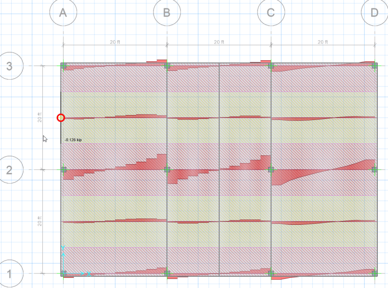

Releasing the moment and shear about the edge in image above yields shear and moment results that I would expect for a typical strip.
Shear:
Moment:
make sure you only select one edge when using this button.
