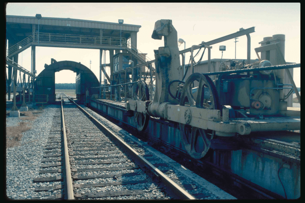

kingnero, EngrPaper - Problem is not everything structural is a building or bridge (which usually have well defined loading code guidance). In this thread, the "...make it stout" comment refers to to railcar positioner track (on the right of this image) where impact loading is unknown:

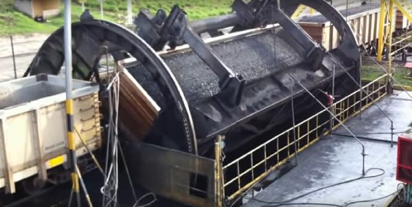

The railcar positioner provides 100% of the force needed to pull an entire (coupled together) train with four large (idling) locomotives plus 80 fully loader coal railcars through a rotary car dumper:
Can't precisely design something if some of the loads are unknown, probably not knowable, and can vary greatly depending on condition of the rolling stock.
