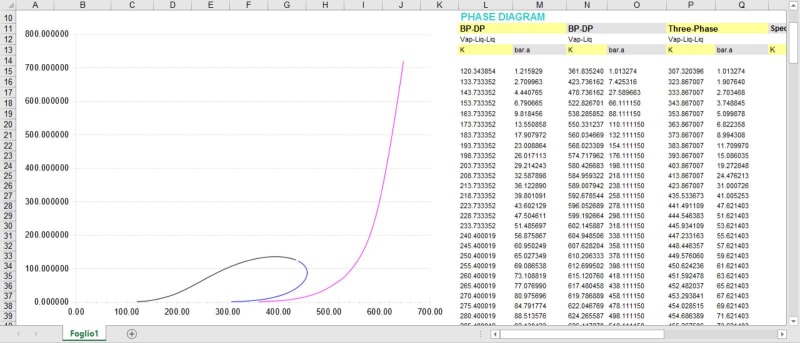

as mentioned by Latex, my copy (sixth, 2014) of API 521 in 4.4.13 (Fires) mentions a minimum value of 50 btu/lb for hydrocarbons near the critical point, API also suggests a dynamic simulation (with sequential / direct integration etc.) to evaluate how composition and fluid properties change, with hydrocarbons + (high fractions of) water you can obtain a phase diagram showing a separate water line
calculated with Prode Properties for a mixture C1-C15+water, the water is the last component to evaporate which means high T, P (high stress),
for these reasons (in my opinion) it's better to evaluate the different conditions instead to adopt a predefined value.
