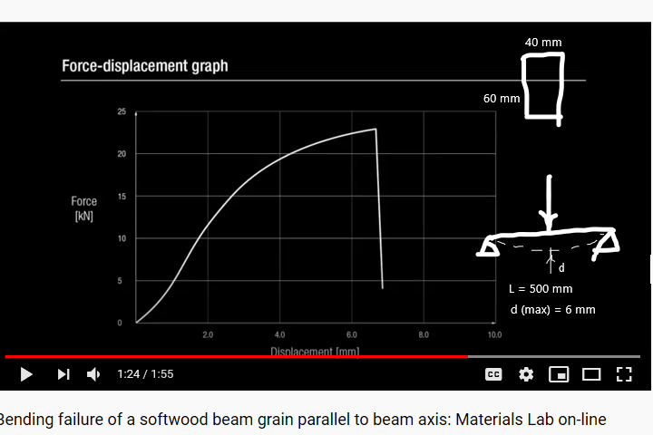

The u-tube link, Link

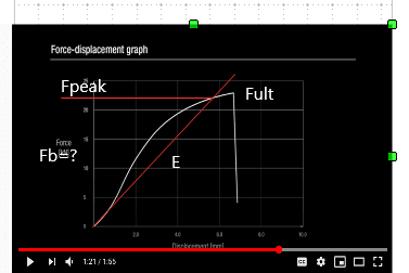

From the test setup below, I back checked the Young's Modulus of the wood specimen, the result is E = 2x106 psi, which is at the higher end of the usual range 1.2x106 - 2.0x106. IMO, the failure performance of the specimen can still be seen as ductile until rupture. (P = 23 kN, Fb = 17.4 ksi)
I disagree quite strongly retired13:
1) There just isn't anything ductile looking about that graph. Quite the opposite.
2) A higher modulus only means that the piece in question would attract load, and fracture, that much more quickly within the assembly.

I just add the resulting bending stress near failure/rupture. I don't know the allowable stress of wood, but guess it would be much lower than that calculated. Then look at the P/Δ diagram, the smooth curve indicates linear elastic behavior to a certain point, then change to non-linear plastic until sudden failure. So, I believe, wood beam is considered a ductile element within the (code) specified stress range.
[ADD] Also note the large deflection, Δ/L = 6/500 = 0.012, Δ = L/83, wow.
In didn't think about defects in comparison. Wasn't wood been inspected and graded for structural use? Any material with defects would have a lower ultimate strength, doesn't it?

I think wood designer can point out the maximum allowable bending stress on the diagram.
The maximum allowable fiber stress of selected structural, for beams and stringers, arranged from 1000 psi to 1500 psi. Very low in the diagram.
