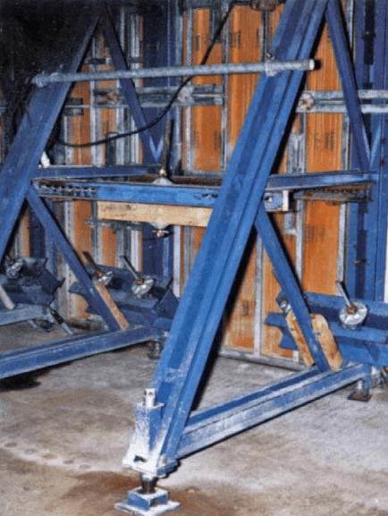

I am designing the bottom tie support of a single sided formwork with A-frame. I have calculated the horizontal reaction force due to concrete lateral pressure. Can anyone lead me to a reference on how to calculate the vertical force due to uplift?

Exactly. The vertical force in uplift is a function of your brace angle, since the horizontal brace force is known, and the brace must carry load as axial compression.
Although I'm not sure how a single-sided form has a "tie". That term is usually in reference to a tension-only member (like a steel rod) that passes through both sides of a two-sided form. A sketch would help.

Is it something like this form system photo?
If so, you have calculated the lateral form pressure, and the resulting lateral force equivalent and distance - take moments about the leading edge screw jack of the form frame, and divide by the distance between the front screw jack and the proposed form tie back ==> vertical force.

Some single-sided wall form systems are tied using these sacrficial form ties:

Ah, I think maybe I get it now...it's what we'd call an overturning load in a retaining wall?
Yes, Ingenuity, that's exactly what I was referring. That's very helpful.

The the concrete is contained behind the forms, correct? If so, buoyancy doesn't apply. The uplift would be from an overturning moment, would it not? Conservatively neglecting friction between the forms and fluid concrete, it's just the moment due to the resultant of the lateral fluid pressure on the forms acting the distance from the bottom to the centroid of the pressure (1/3 the depth of the fluid concrete. That moment must be resisted by the weight of the form facing plus either a hold-down force at the bottom of the facing (Uplift = M / width of the A-frame base) or ties such as the ones Ingenuity showed in the sketch above (Tie tension = M / height to the ties from the A-frame bearing elevation).

One sided systems like Ingenuity posted typically rely on threaded rods cast into the previously poured footer, at an angle relative to grade (often 45 degree). So the horizontal concrete pressures are resolved into a tension load on the threaded rod, and a vertical reaction at the frame leg furthest away from the new concrete. Rest is statics.
