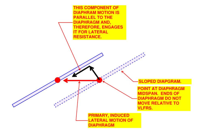

2) A sloped diaphragm that is shifted laterally in space is induced to move in its own plane because the lateral motion contains a component of motion along the plane of the diaphragm. Therefore lateral motion engages a sloped diaphragm structurally. See my sketch below. This probably should be obvious but I struggled with it for a long time.
We good on these points? I have more than one way to present this if more is required. I love vectors as much as the next guy but they tend not to be super effective at changing hearts and minds.

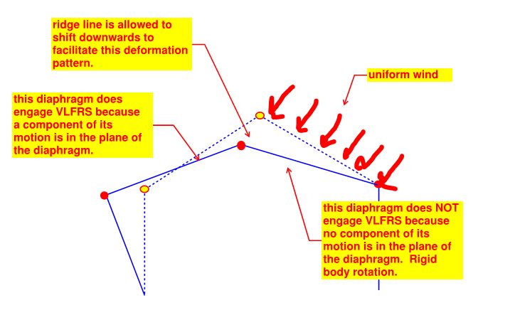

What I've attempted to understand here is HOW we assume these two planes act together. What really trips me up is that I think the proper way to handle the 1/2 projected wall height is to take the lateral load coming from the wall, and find the vector that pushes load into the plane of the diaphragm.

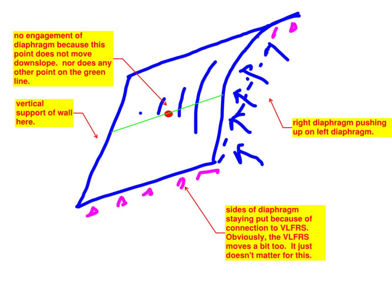

I agree completely and have shown a situation below where I believe that the left diaphragm does not, in fact, participate in resisting load. If we're on the same page with this, I'll get into what is required to encourage both diaphragms to participate as we typically do in design.

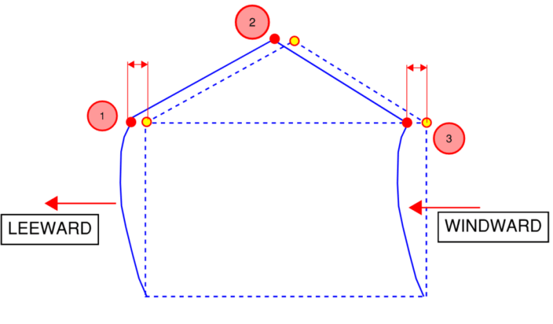

1. That applied wind or seismic will have forces on each side of the building (i.e. windward/leeward wind).
2. That overall drift of the building (not diaphragm) will move nodes 1 and 3 to the left.
3. That we likely assume there to be some local deflection in the vertical wall elements (not sure this one matters at all for your situation).

1. That applied wind or seismic will have forces on each side of the building.(i.e. windward/leeward wind).
Yes. More complex situations can be handled by way of superposition. It is just easier to elucidate important points by paring the situation down to only that which is truly necessary.
Yes. For the sake of discussing diaphragm participation, all that matters is relative displacement between the diaphragm and the VLFRS.
Let's assume that there won't be. It's not germane to any of my arguments.

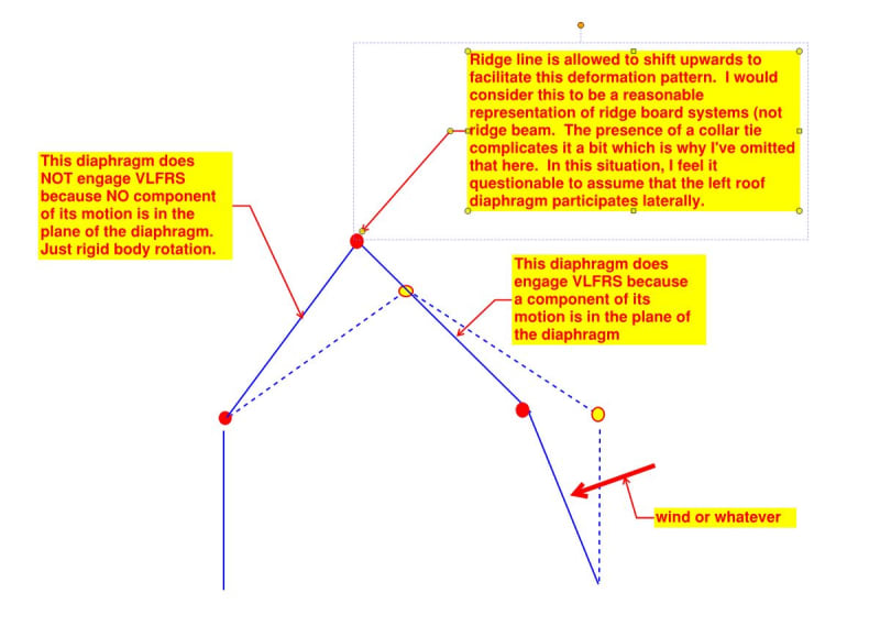

1. We're only looking at rafters, right? Similar to if a collar tie was present, a real truss is going to complicate this?
I'll get to this later. For now, I've deliberately limited the presentation to pin ended rigid bar models to keep things simple. Consider the model to not represent anything other than a pair of generic, weightless diaphragms.

Well, the conclusion that I'll get to eventually is that, in most practical cases, it is reasonable to assume that the diaphragms share load. Probably not as uniformly as our methods suggest but whatever.

Now for the wind that is normal to the roof (i.e. roof wind load), I understand there is no axial force in the plane of the roof due to wind (therefore you cannot say that wind is pushing parallel into the plane of the roof). But based on the vertical projection of the roof, there is a lateral reaction at the eave and ridge. You can solve that with a FBD, but I don't understand the mechanism behind how the diaphragm "feels" this shear load transfer in the plane of the roof since the wind component is normal to the roof.
So this is how I view that concern. Again, I'm not considering supporting framing yet. These are just skyhook diaphragms shifting around.
This follows the same logic as my previous investigation of the wall load case. Here, the left diaphragm receives the in plane wind load even though it is the right diaphragm that is acted on by the wind directly. And the question becomes, just as you have postulated, why does the right diaphragm "fee the shear load". I'll start speaking to that next.

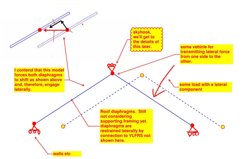

In the sketch below, I've created a model that I believe would force both diaphragms to engage laterally for all of the load cases that we've considered so far. The skyhook restrains the diaphragms from rigid body rotation that would produce no in plane diaphragm shear and forces both diaphragms to shift laterally.
I've made this deliberately abstract to drive home the point that I'm trying to make. We'll get into the practical details of the boundary conditions next.
For now, are we agreed that if the boundary conditions shown below were present, both diaphragms would engage?
