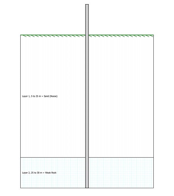

Hi all,
I'm want to analyze pile group using p-y curves metthod. I start it with modeling a simple single pile for verification with LPILE results. Every time i model pile and soil in sap2000, i get different results from LPILE. I search books and articles but none of them have my problem. can anyone help me with this? I really need to this as soon as possible.

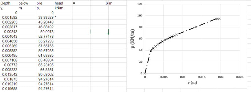

i create p-y curves of sand profile in lpile (every 1m along the pile), and then i used this curves in link element (multilinear plastic). since i create py curves every 1 m along the pile, so the tributary length of every node is 1 m, and p-y curves remain unchanged when converted to f-y.

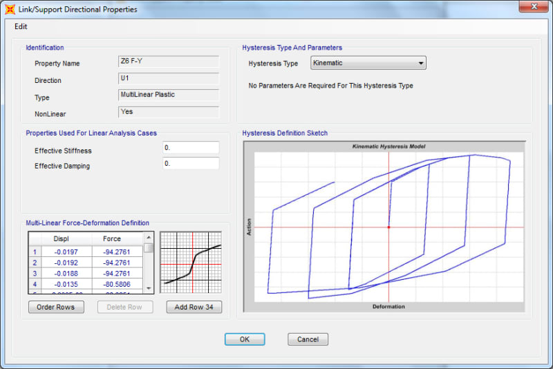

as i said, i used the p-y curves from lpile to generate the f-y (force displacement) curves that are used in Link element. so for every node along the pile i have on specific link element. i specify the link type to be multilinear plastic, based on a method that is described here in csi page:
for example for the first node ( 6m below the pile head):
orginal p-y curve from lpile
Link element property data
Link directional properties
