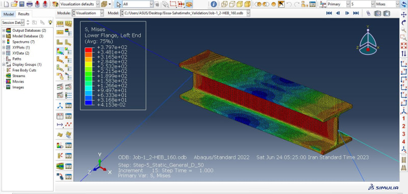

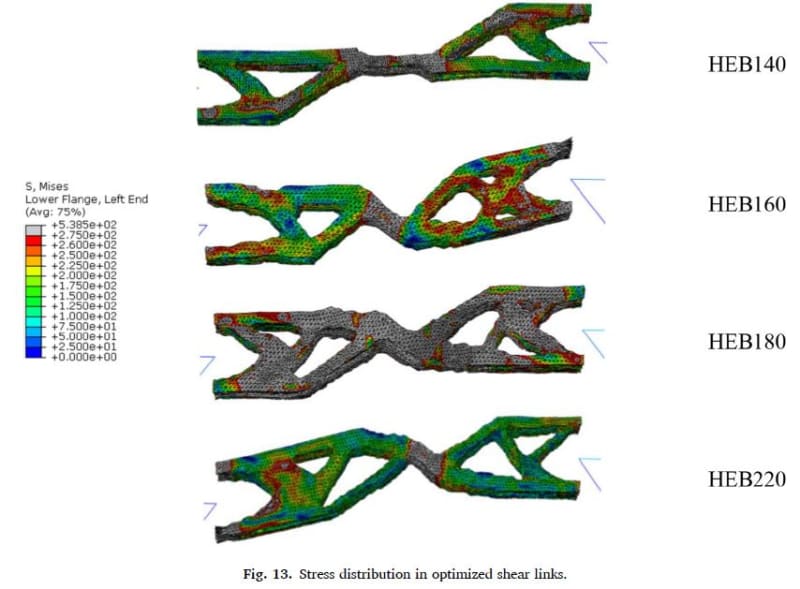

Hello everybody.
I'm working on simple structure from a paper, "On the topological optimization of horizontal links in eccentrically braced frames", That need to be validated.
So far, I think done all steps according to the source paper but still there is something fishy that I can't figured out. So, in order to show you fellow community to what is what I describe the steps in the bellow PDF file Link.
I think the main problem is The Beam (in both of I Shape and Box Shape) did not properly deform and my stress and displacements values (specially in optimization process) are not within a reasonable range.

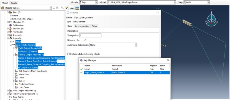

The only thing that can find in the source paper and don't know where and how should apply it is:
1-
Source-Paper said:
To allow links deformation during the loading procedure, finite deformations are considered in the FE analysis.

To consider finite deformations you just have to set Nlgeom to On in the step settings.
For easier comparison of your and reference results, you can set the same limits for the scales of the contour plots as the ones used in the article and import their XY plots as "From keyboard" (you will have to read the data points first but there are various small programs that can digitize plots from images).

Yes Indeed, And also i did the same thing in my simulation.
But sadly the output is not the same as The source paper demostrated.

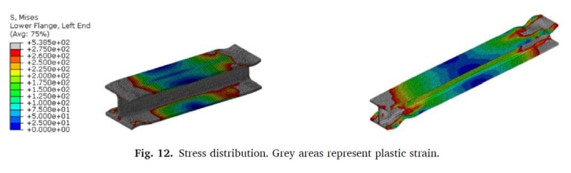

Source paper:
What I done:

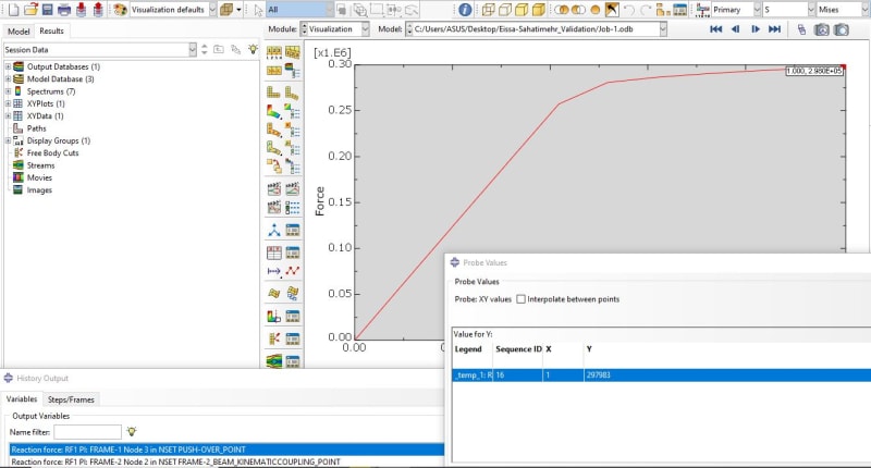

As can seen The amount of the Stress and Deformation did not match. On the other hand Reaction forces in X direction match together !!
Source paper:
What I done:
So I totally lost what is what ?!

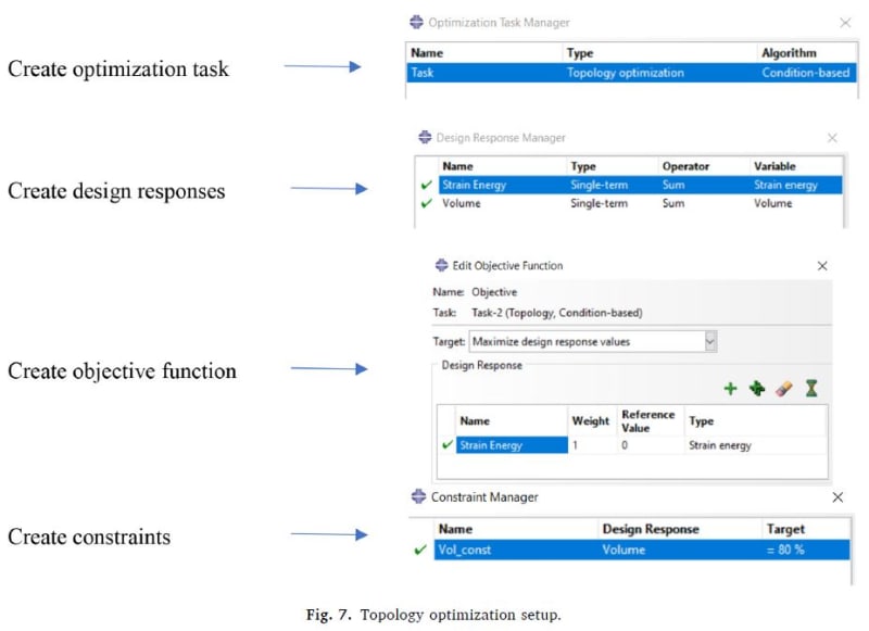

Also in optimization process the amount of Reduction that I done is in accordance with the paper framework, But Results they show is significantly different what it should be ?!
Paper framework for Optimization:
What I get from this kind of configuration:
What paper Show as Result:
So Confusing !
