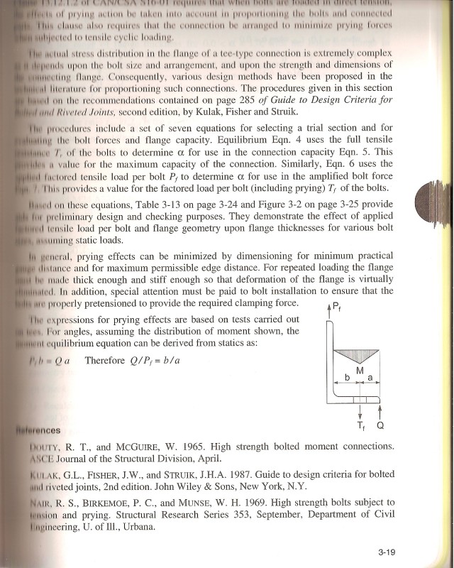

Attached is an excerpt from the CISC Handbook regarding prying action. It appears to me that the value of Q should be approximately the same as Pf when a = b. That would suggest the value of Tf should be about 2*Pf.

Yes, if we only had Tension at horizontal bolt then I agree 2Q=Tension on vertical bolt. However we have both T and V at horizontal bolt. (just resolve the moment on bolt line as M=F/(h-b)) (there is an assumption that angles are rigid and hence shear is transferred equally V=F/2). Now V and T counteract each other. The way I see it, when T wins we have rotation about the angle tip and Q exists; when V wins, we have rotation about the heel and no Q [however at the heel there will be a new Qlike force directed upwards)... and that force might just be equal to 1/2 the vertical bolt tension for a=b. Hmmm, but atleast we counteract alot of moment when we cross T against V.

Cause the system is indeterminate, in fact depending on the situation you may have prying on both toes of the angle, or on edge 1 and toe, or edge 2 and toe but on perpendicular axis. In fact, in the end I did not go with the assumption to which you're responding. I'm just exploring possibilities here. The only way to surely know is to make an FEA analysis or something like that. + testing. But it still wouldn't give me a generic equation applicable to wide range of situations. Unfortunately.
