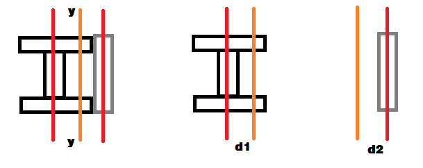

Hi Guys,
Just wondering how to work out the bending of a beam, that is reinforced with a flat-bar?
Or any piece of material for that matter (angle, C-section, ect.)
Example:
If you had a standard I-beam 30mm high, that had a piece of flatbar stuck to it's side - 30mm high (fixed to top and bottom of I-beam), how do you work out the moment of the area cross section?
Can you assume that the new area is simply the addition of the beam and flatbar areas?
(This is assuming that the flat-bar is fixed quite well to the I-beam.)
I know there are composite beams (and their associated calculation methods), but in my example above both materials are exactly the same....
Any help is much appreciated, and nice to join the forums!!!

In the case of above:
The I-beam and the flat bar have planes that are parallel, but for them to be coincident they would have to be superimposed on-top of one another (not possible)...?

surely it's "just" re-calc the section properties of two pieces (the I-beam and the plate), using as suggested the parallel axis theorem.
I don't think it's a shear center problem, the load is just simple bending (not offset).
So using the parallel axis theorem, do I find the new centroid, then calculate the moment of inertia of each section, about this new centroidal axis?

so is the following correct:
New centroid axis is y-y.
To calculate bending about y-y,
Sum the following two moments about the new axis:
Ibeam + A x d12
Iplate + A x d22
Ibeam + A x d12
Iplate + A x d22
Yes, this will give you total moment of inertia about the new centroidal y-y axis.
Euphoria is when you learn something new.
but note that the extreme fiber distance has also changed.
and just so as we're on the same page …
y_NA = A_plate*y_plate/(A_beam+A_plate)
on your sketch y_plate = d2+y
