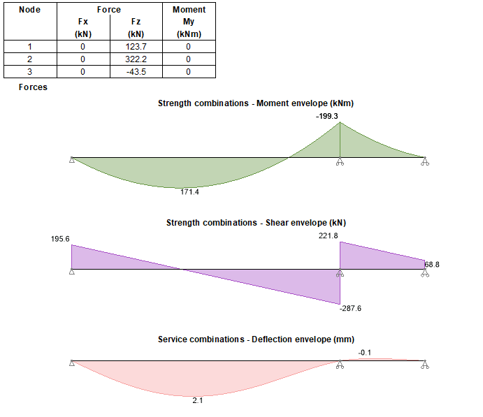

1) Continuous beam, three supports.
As you have shown.​

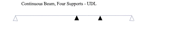

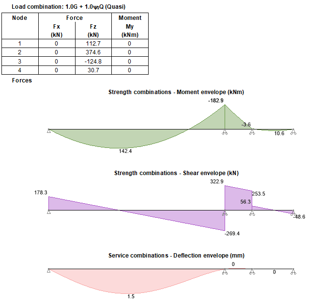

2) Continuous beam, four supports. Middle supports located in 6" from the edge.

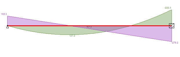

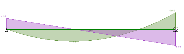

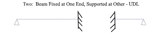

3) Two each, beams fixed at one end, supported at the other.

Thanks for the response, I appreciate your advice as always - please see the output results below :
1)
2)
3)

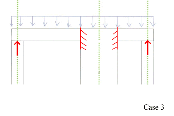

IMHO, both Case 2 and Case 3 are reasonable ways to (simply) model the continuous beam. The "best" answer is probably somewhere inbetween the two cases. For the given conditions, both cases will likely put a distributed load on the center footing... but it will not be uniform.

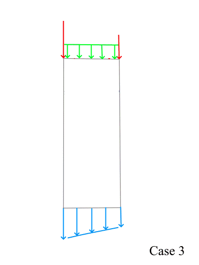

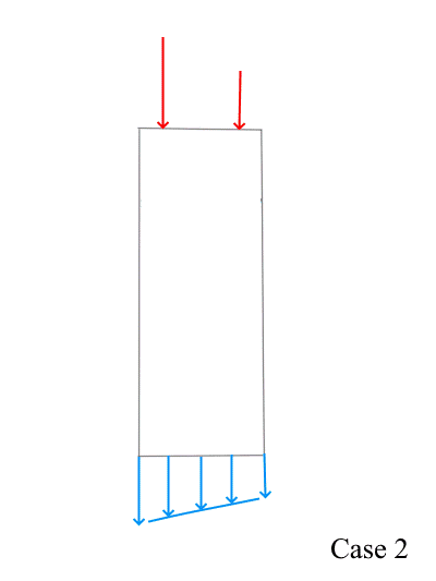

Consider Case 2:
Loads on the two center supports are not equal. This means eccentric loading on the the center "column". The two point loads (shown in red) will distribute quickly over the length of the "column", but the eccentricity remains and is applied to the footing (shown in blue).
Also, check Case 3:
There are three loads on the "column" in this case; two unequal point loads (red) and the original UDL along the three foot length of the "column" (green). The result will be eccentric "column" loading, different than Case 2, but applied the the footing in a similar way (blue).
Compare footing loading for Case 2 and Case 3. The higher of the two is what I would use to evaluate the existing footing.

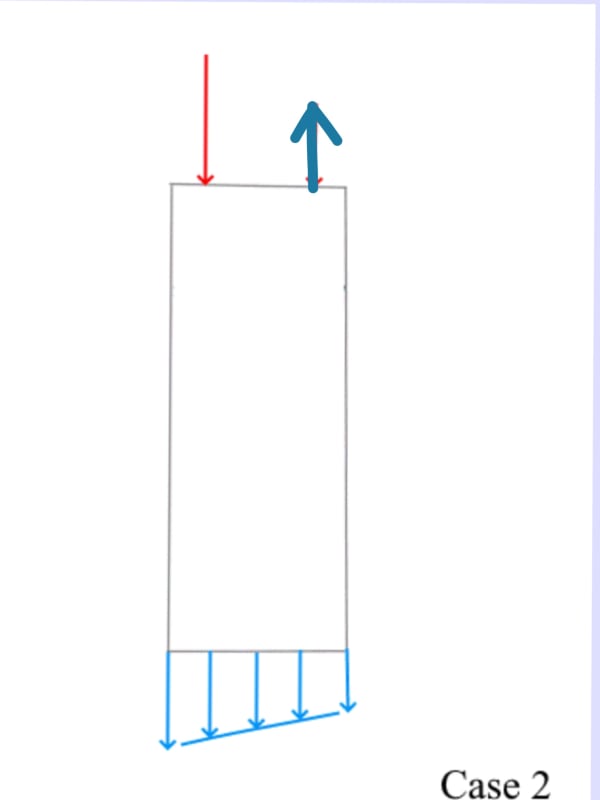

I'm still a bit confused regarding load Case 2, as the third support has a negative reaction, should the loading be like this?
I haven't decided yet if I'm going to have the transfer beam tied into the wall or not. If the former, should I just assume a 0kN uplift at the 2nd point load location? If the latter (tied into the wall) use the node reaction force as uplift?
Redacted - Use the results of your calculations, that's what math is for. If there is a negative reaction, then there is uplift as you are showing. But this applies only if the beam is anchored to the "column" so that uplift on the beam causes equal uplift on the "column". Will that be the case?
