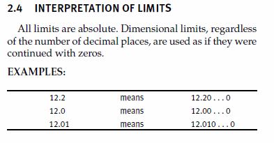

Anything that is out of tolerance has grounds to be rejected. It is at the engineers discretion if they want to accept the deviation, and that decision could be based on a number of things. But it is spelled out in the ASME standard. Per ASME the tolerance is absolute and interpreted to be followed with zeroes.
This thread has the relevant part of the standard copied in there Link
By your logic if you had a shaft and hole/bore that both had three decimal places tolerances. Both could be .00044" out. You could have almost .001" less clearance than the designed minimum clearance, and with your rounding rules, everything would be in spec. I could definitely see a design where this would not be acceptable. If the print is designed per the ASME standard then the parts are out of spec. If you design to a different standard which incorporates the rounding rules you specified, then you would be correct, as long as it's clearly spelled out what standard is used, and the prints are made accordingly.

A print that does not have GD&T can still be to ASME Y14.5M standard. A lot of prints I've seen have a default "DRAFTING PER ASME Y14.5M UNLESS OTHERWISE SPECIFIED" even if just linear dimensioning is used. The standard defines rules that are applicable to when just linear dimensions are used. In general I would interpret a print to ASME Y14.5M unless it is otherwise specified, as that is what is most commonly used in my experience.
If no standard is referenced anywhere, then you may have found a gray area, which is exactly why these standards were developed. If it were me, I would just defer to ASME Y14.5M unless it was explicitly stated otherwise. And if it came down to a legal argument, where no standard is explicitly specified, I think a case based on a professional and well established standard would do better.

It seems to me that they are discussing formatting issues, and not disputing paragraph 2.4 in ASME y14.5M-1994 (which is even posted in the thread).

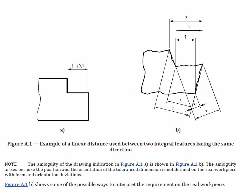

If a standard is not being followed then you will have more problems than just significant figures/rounding which you are concerned about. Traditional dimensioning is inherently ambiguous for things other than what Y14.5 defines as a Feature of Size (and even then is subject to some ambiguity/nuance in certain cases but less so) and often requires integration of special notes and in some cases description of how a feature should be measured to achieve some semblance of expected conformance.
Below is an example of what seems like a simple linear dimension between two surfaces which is in reality extremely ambiguous. Utilizing the universal "language" of ASME GDnT or ISO GPS minimizes such ambiguity. If no standard is specified, two different suppliers or even two different operators could give wildly different measurements - significant figures would be the least of your concerns.
