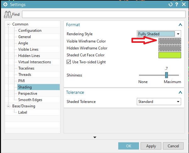

Go into the view Settings of the drawing view.
RMC on drawing view border -> Settings -> Shading
I am on NX1883, so it may look a little different than yours.
In my menu the greyish color is set because that symbolizes that the solid edge is the same color as the solid body.

Not sure why, but when I change that color I don't see any changes at all. Is there something else you do that special? I have the exact setting that you posted above.

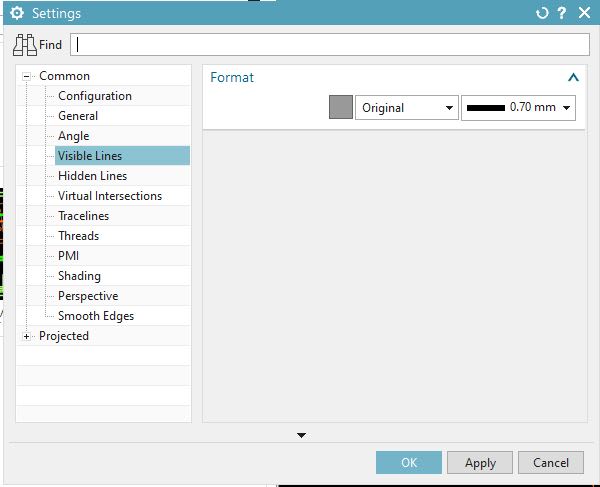

Maybe try changing the Visible Line color, six settings (on the left of the menu) above these shading settings.

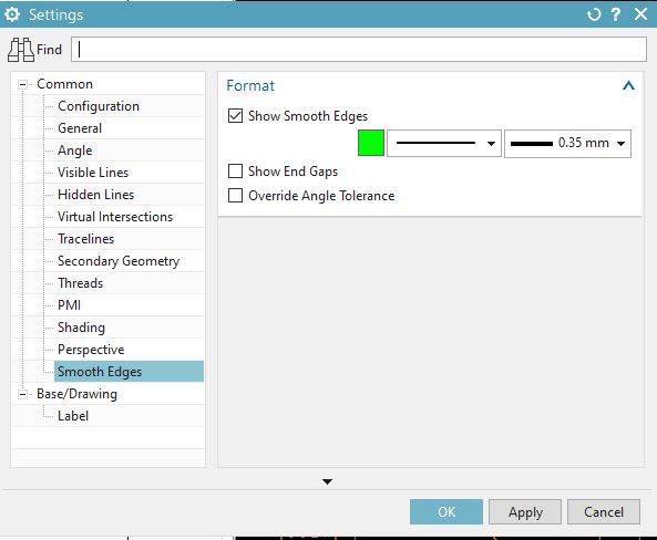

I did find one more thing.
Make sure the color of the Smooth Edges is changed too.

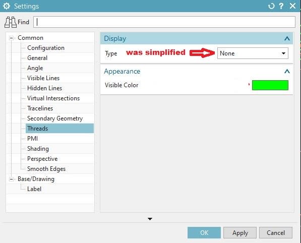

If you have threads it you may get a better result if you turn them off in a shaded view
