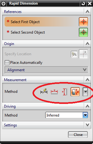

Hello,
In rapid dimension window I can use Show Shourtcut in Mesurement Method.
But I can see only four icons:
Is it any method for show more icons?
Best regards
Michał Nowak
NX9 & TC10
The shortcuts are dynamic, they're the last 4 that you've used.
