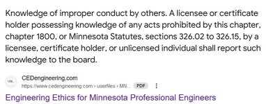

Michigan State Law (and every other engineering practice law I'm aware of) requires an engineer to undertake only that work for which they are competent. I'm not saying you're not intelligent - the ability to recognize your lack of knowledge and seek help shows you're better than most - but experience matters in measuring competence.
Michigan Administrative Code, PE Rules | Part 3. Standards of Practice and Professional Conduct | R 339.16033 Participation in engineering projects; competence required:
Rule 33. A licensee shall undertake to participate only in those phases of a project in which the licensee is competent. In the areas of a project involving architecture, professional engineering, and land surveying in which the licensee lacks competence, the licensee shall retain licensed professional associates for those phases of that project.

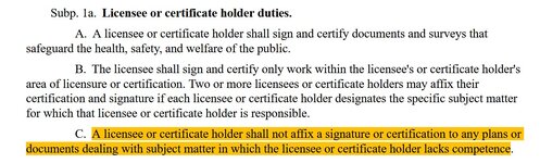

I'm not even going to bother addressing your attitude about "frou-frou" gibberish (i.e. Legal Requirements). That sounds very very like Stockton Rush and his attitude toward the testing requirements for PVHO.

Basically an admission that you've routinely practiced outside your area of competence. Where did you say you were practicing again? Or were you intending to self-report as this is also a "frou-frou" legal requirement?

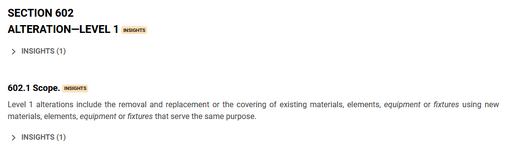

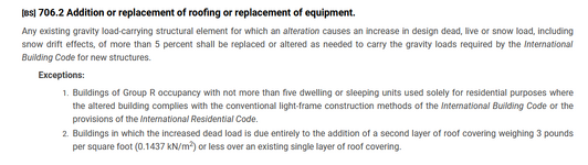

  • IEBC Alterations Level 1 - Addition or Replacement of Roofing or Replacement of Equipment.jpg

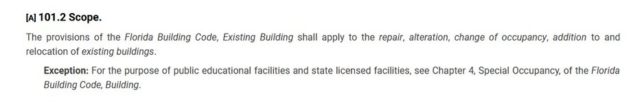

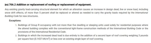

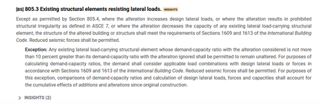

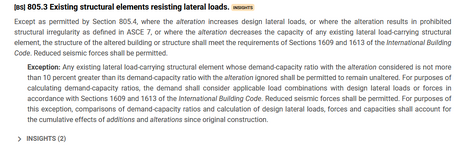

I think the IEBC says that you can increase the lateral load on any element by up to 10% without modifications. So I could see the logic that if you remove less than 10% of the wall in a level (assuming it's drywall) then you don't need to justify it any further.

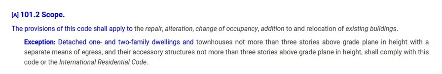

If only the IEBC actually counted as residential code, which outside of Florida (who specifically amends to include residential structures), this isn't quite viable as a strategy. It's also not engineering, it's hand waving.
Florida Building Code, Existing, 2023, eighth edition
2021 International Existing Building Code

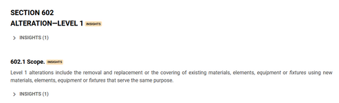

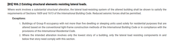

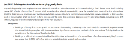

Let's step back a second, because we need to classify the work first:
Furthermore, as of 2021 IEBC, now that we are talking about it, it's 5%, and it is in Alterations Level 1 - (this is pretty restrictive) and the language is as follows, this particular provision is related to snow drifts and design dead and live loads, and it's strictly interpreted as applicable to alterations, i.e. you aren't removing lateral or gravity load elements:
This does not fit what is described here by the OP.

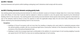

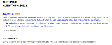

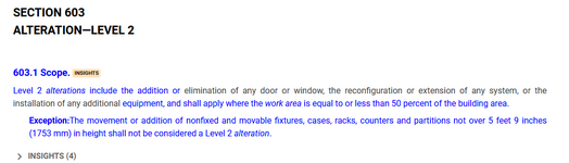

Alterations level 2 is based on a work area, less than 50%, so it would seem to apply to deleting a loadbearing wall or a shear wall. There are at least provisions in that portion that seem to make some sense for such work, as well.
This doesn't really fit, thematically, with deleting a load-bearing wall..... but the 5% increase wording is still in there.
As far as deleting a shear wall, alterations level 2 states: "alteration that decreases the capacity of the existing lateral load-carrying structural element......
Still not quite seeing a load-bearing wall, but there's some discussion of substantial structural alteration in Alterations - Level 3.
Substantial Structural Alteration is defined as:
Well, Level 3 is less useful than Level 2. Language pertains to lateral load resisting elements and points at the IBC.

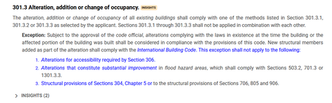

I think the answer to the load-bearing wall question lies in Chapter 3. (When it is not a shear wall).
"New structural members" added "as part of the alteration" shall comply with the IBC.
