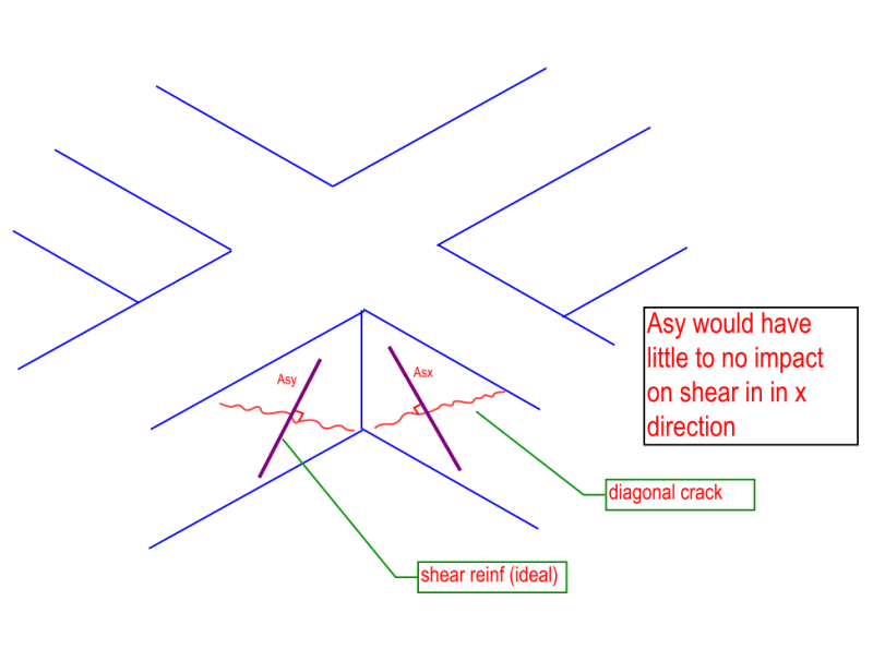

In a two slab (supported on walls), if designing manually using strip methods, should the shear reinforcement required for x direction (Asx) be summed with the shear reinforcement required for the y direction (Asy). The total area (As) be applied to the critical regions?
Otherwise, is it safe to simply design a strip for the maximum shear force (whether its in the x or y direction) without summing up the As.shear required for both directions?
This is an issue that has caused a lot of confusion in my office with many clashing opinions. In a strut and tie model, each direction has a vertical tension force that needs to be resisted, so it does make sense to me to design the slab for a sum of the shear. See diagrams.
Yes, I would expect something like the root sum of squares, as it accounts for the longer diagonal length in the combined direction, rather than a straightforward linear addition.
Alternatively, you could directly check the critical shear plane, such as a diagonal across the square that produces the highest perpendicular shear stresses, and evaluate that plane for one-way shear stresses. You will have a certain concrete area and tie area perpendicular to that plane, which can then be assessed.

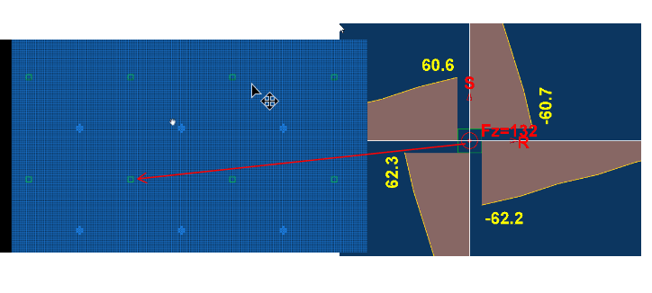

hardbutmild said:
try making your mesh 10 times smaller in your example, do you get the same result?

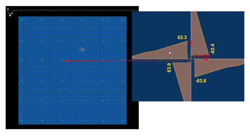

Yes, pretty much the same exact results. 2ft max meshing yields this:
A finer mesh 1ft max meshing yields this:

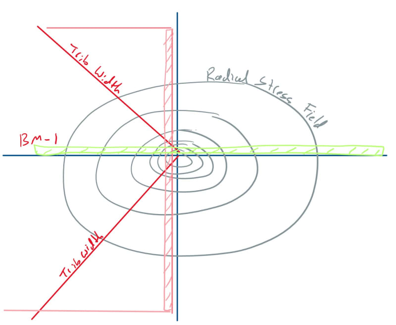

this type of shear is designed for reaction along 4 faces, so even the 1 strip idea that you posted will give you the wrong force for design.... it’s going to fail by the formation of a circular crack and what a surprise,
This feels like you are going back to the punching shear item, lets ignore that for now. Assume that shear reinforcing for one way slab shear checks was required right the middle of the slab, no punching shear problems in sight.

In theory, the shear reinforcement would run perpendicular to the diagonal crac. If you consider the strip running in the opposite direction, its diagonal crack also runs in the opposite direction per the sketch below. Therefore, the shear reinforcement for each strip needs to be designed to resist the shear in that particular strip.
That may be the optimal way to orient reinforcement but it's not the only way. In modern times, shear reinforcement is usually oriented transverse to the plane of the slab for reasons of constructability. As you can imagine, running two systems of opposing, orthogonal, diagonal shear ties/stirrups through a common area would be quite the rebar placement nightmare.

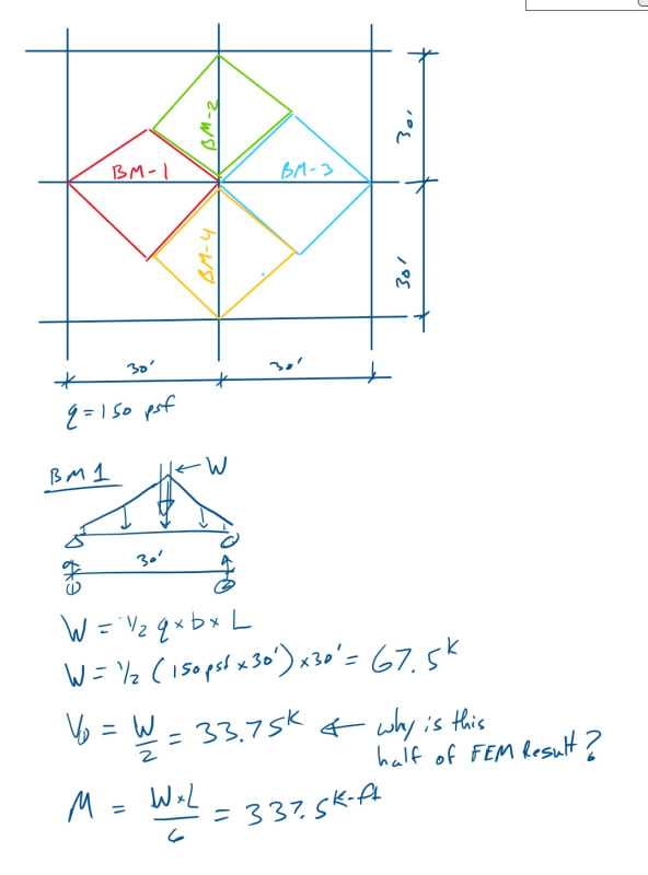

Here is why I struggle with the FEM results and end up finding myself in the "double counting the load" camp...
If I stay with SticksandTriangles example and I were to look break up the slab into four beams along the column lines and design for tributary load. I would get 1/2 the shear that I get from the FEM model, why is this? See example below:
After some outside consultation, I suppose this is "why" they are not the same...
The strips are overlapping and essentially integrating the same stresses over the same areas (see image below). So it is "double counting" in my mind, but what should the required area of steel actually be? The SRSS argument above seems to have some legs here.
