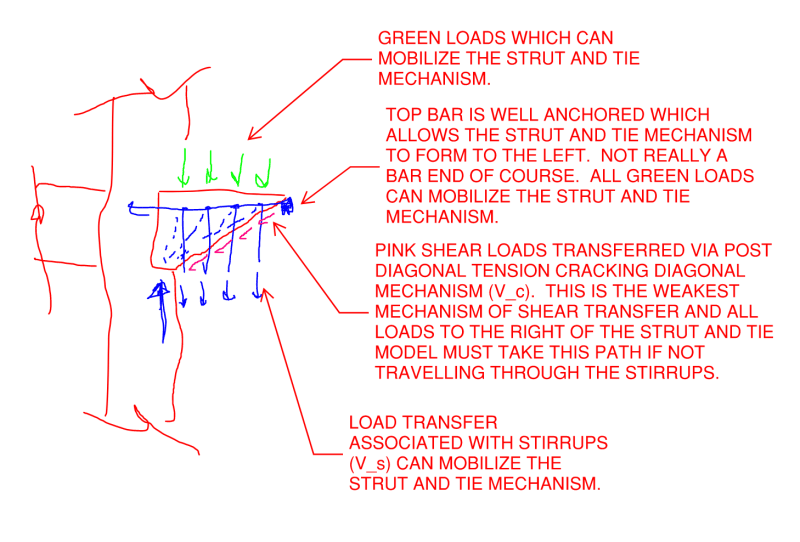

Following equation is for the calculation of shear r/f for a beam according to Eurocode. The Eurocode expects us to calculate the shear force at a distance of "d" from the supports.
Let's suppose the shear force at a distance of "d" is 150kN, and red arrow shear force (from a point load etc) 400 kN, more close to the supports than a distance "d" shear force.
My question is, if there are any bigger shear force (from the red arrow point load) is present more close to the supports, aren't we missing the critical red shear force?
The critical shear force is not the shear force at the distance at "d" in this case, so why we take the shear force at distance "d"?

I felt the 'strut angle' can be like more than '45 degrees' (for the red concentrated load) and it can directly transfer to the bottom area before the supports. Because, we are designing the beam for the shear load at a distance at "d" at that point the angle is ok, but we have a very large load before distance "d", that would not transfer to the supports as it definitely will not form a strut angle lower than 45 degrees. I might be wrong though.
I feel that's about right. Loads imposed closer than [d] from the support can take the favorable, 45 deg strut and tie path from the point of load application to the support. Ditto for shear loads moving towards the support via the stirrup reinforcing. Shear loads beyond [d] and not travelling through the stirrups must travel to the support via the much weaker, diagonal shear resistance mechanism along the hypothesized 45 deg diagonal tension crack.
The code relaxation is basically an acknowledgement of the relative strengths of these different shear travel paths at the support. As the other folks here have mentioned, additional checking would be required for concentrated loads near the support because:
a) Such loads might overload the strut and tie model, which can be checked.
b) Such loads might produce a shear failure within the strut and tie model at an angle steeper than 45 degrees. This can also be checked.
The concept at play is that, since the strut and tie path is so much stronger than the diagonal shear path, a little extra uniform load is unlikely to exceed the capacity of the strut and tie path.
